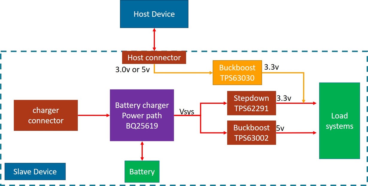

I am now developing a system as the following figure, and the slave device part is what I am doing right now.
The slave device has a battery and could operate as a standalone device on its own.
The load electronics(MCU, Sensor, etc.) need 3.3v and 5v, so I use two regulators to have these two voltage supply.
The slave device could also connect to a host device. With different host devices, the host device could possibly provide 3v or 5v.
I would like to use the power provided by the host device while connected to share the current of the load system to extend the battery life of the slave device.
Could I naively connect the outputs of TPS63030 and TPS62291 together?
