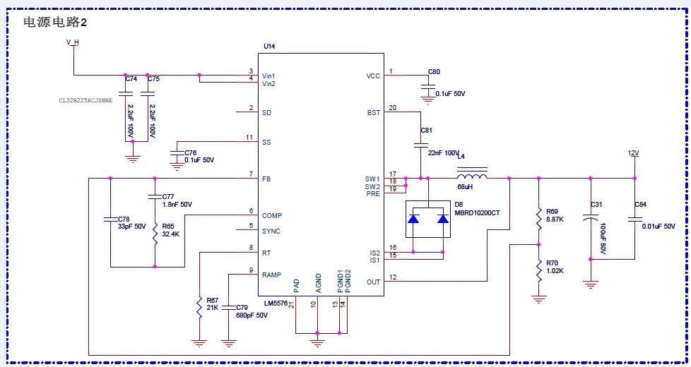

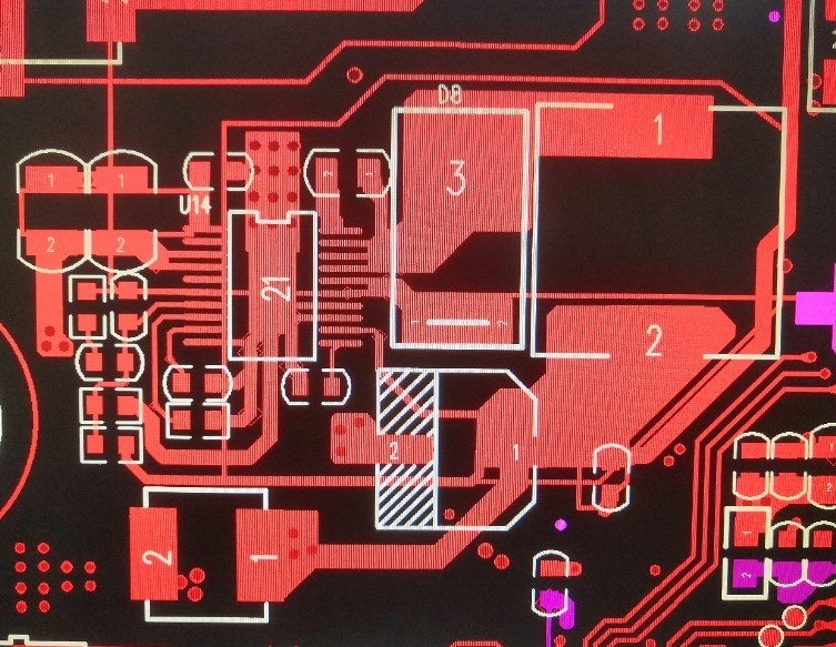

my customer use LM5576, Input voltage =48v, output voltage=12v, normal out current is 400ma with load ,but now there has no output signal ,Is there any good advise for this prroblem? thanks in andance
dear
HI Raymond,
How about ESR of C31?
Pls try below component value:
R65=6.8K, C77=18nF, C79=520pF.
Connect C74, C75 GND to U14 ground pane directly with short and thick wire.
