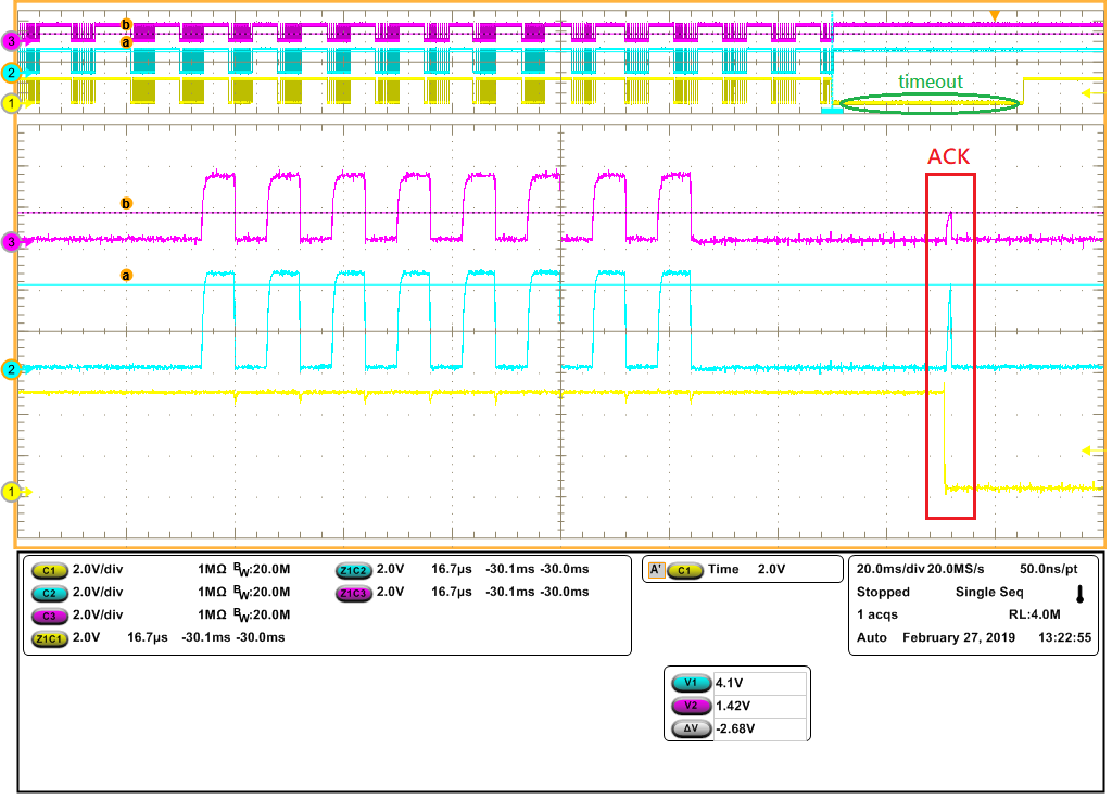

Hi TI experts,
I use UCD3138 test PMBUS write with microchip pickit serial analyzer. UCD3138 is slave, microchip pickit serial analyzer is master. I found if UCD3138 pull low clock before the ACK, the ACK clock is short. This condition only happened at every 4 byte(Not including address).
please see the waveform as below,
ex: write data [S_][B6][48][D0][39][4D][2E][53][41][30][35][P_]
So I want to implement that UCD3138 don't pull low clock before the ACK, how can I do?
And I want to implement PMBUS with interrupt, how to configure the register and firmware?
Thanks!

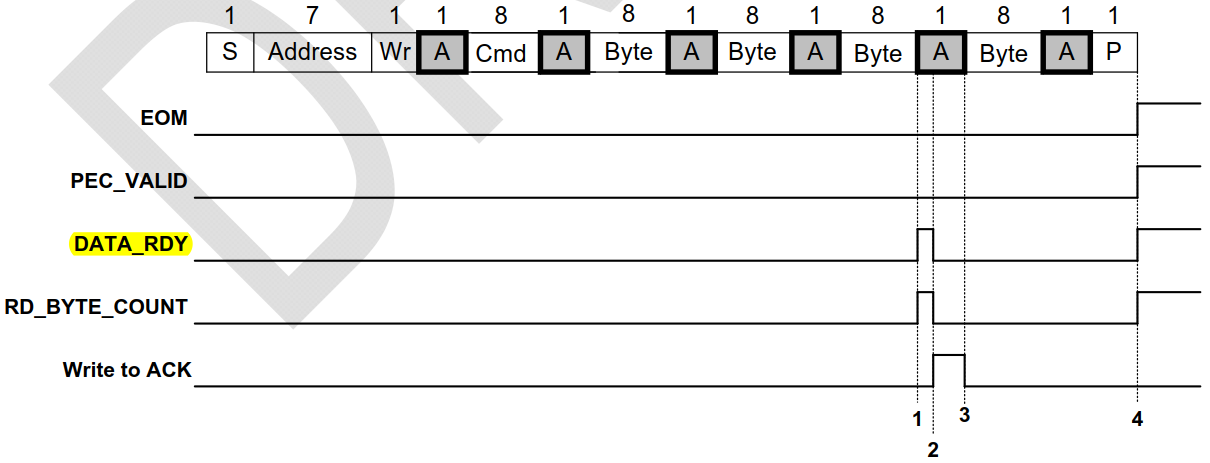

  • It's very difficult to prevent some clock stretching.  The stretch is caused by the hardware waiting for the firmware to take the data from the receive buffer and ACK it.
    You only have half a PMBus clock cycle to respond, if you want to do so.  I can't really tell what your clock frequency is - can you tell me what the time scale is on the zoomed in screen?
    At 100 kHz, you only have 5 microseconds.  At 400 kHz, you only have 1.25 microseconds.  With the need to have fast interrupts for other things, this means that you really can't avoid at least some clock stretching.
    Most micro controller systems have to have clock stretching.   It doesn't seem to cause any issues with the communication anyway.
    I think that the short clock is something caused by the way the Microchip handles the clock, since the UCD releases the clock when it gets the ACK from the firmware.
    Without knowing the PMBus clock speed and the Microchip requirements, it's hard for me to say whether the short clock is dangerous or not.
    One thing I would suggest is using a pull up resistor of about 1.5 Kohm.  Your rising edges look like they may be a little slow.  We have found that a 1.5 kOhm resistor is good for protecting the PMBus from noise and other issues.

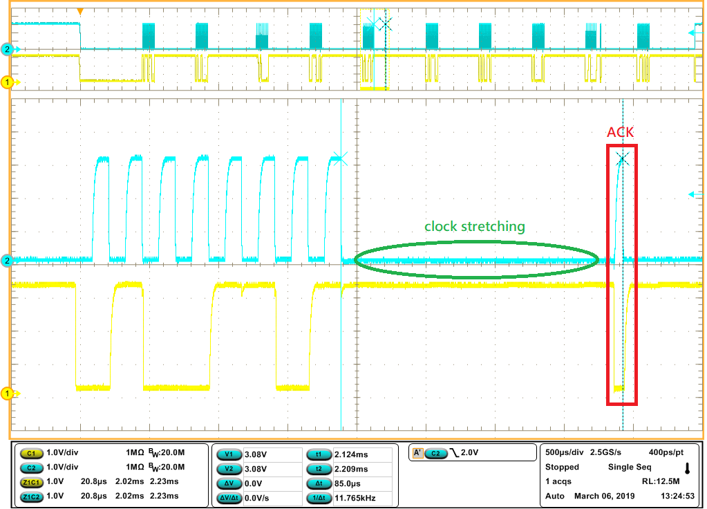

  • Hi Ian,
    I only use PMBus interrupt in boot code, so I don't need other standard interrupt and other fast interrupt. I use the microchip pickit serial analyzer to test pmbus wirte that cause SDA timeout because the ACK clock is short.
    See the waveform as below,
    CH1: Master SDA, CH2: Master SCL, CH3: UCD3138 SCL
    I know that the short clock is caused by the way the Microchip handles the clock, but I need to use the microchip pickit serial analyzer to implement firmware upgrades.

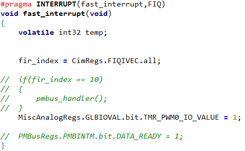

    I configure the PMBus interrupt, but it isn't interruptible. Where do I ignore?
    What register is PMBus interrupt flag? And how to use the PMBus interrupt flag to enable and clear the PMBus interrupt?

  • Hi Ian,
    I want to use fast interrupt in boot code, but I can't implement. I find the boot sample code load_64.asm is different with the AP code. I think I can't implement fast interrupt in boot code because load_64.asm don't configure fast interrupt.
    How can I configure the boot code?
    Thanks!
    d1d4 boot flash 001.zip
  • The only thing the load.asm does is to link the vector for the fast interrupt to the fast interrupt function.  But that is going to be a problem for you.
    Because the boot flash normally links the fast interrupt to the fast interrupt in the main program.

    I know that you are seeing the issue after a clock stretch, but I'm still not convinced that this is the root cause.  i would suggest that you put in a low value resistor, maybe a 100 ohm, in the data and clock lines between the two chips.  That way you can tell which device is pulling the line down.  Also, please try 1.5 Kohm pullups as well.  What pullup resistor are you using now?
  • Hi Ian,
    Thank you for supporting. The pullup resistor is 10 Kohm. I try 4.75 Kohm that can improve. But the pullup resistor 10 Kohm is defined by our customer, I can't change the pullup resistor.
  • Tina, the UCD will definitely not work with a 10 K Ohm resistor.  We recommend at least down to 1.5 Kohm.  10K may work with some devices, under some conditions, but for reliable operation under all conditions, and with all UCD devices we recommend a lower value.  It cannot be solved with fast interrupt.
