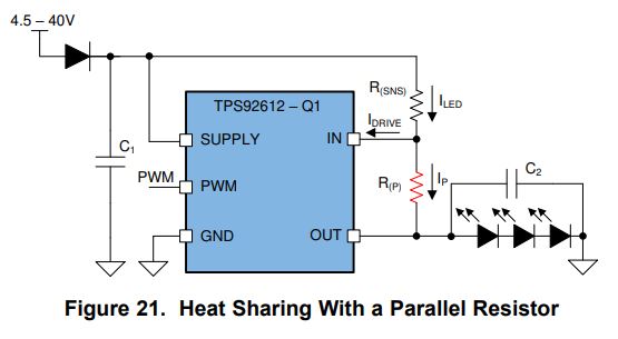

TPS92612-Q1: Heat Sharing resistor Rp
Part Number: TPS92612-Q1
Dear Team,
If we connect Rp (Heat sharing resistor) & PWM is LOW then there will be some current flow from
VDD--> Rsns --> Rp --> LED--> GND.
How to avoid this situation? Do we need to add one more switch in supply path for each driver?
regards
Vinod Sharma
  • Hi Vinod,
    If you want to use Rp to share the thermal, you can add a PMOS to control the  Rsns --> Rp --> LED trace.
    But I recommend you to use a larger package device or use diode series with LED in a thermal considering application.
    I think that cost should be lower than using a PMOS.
