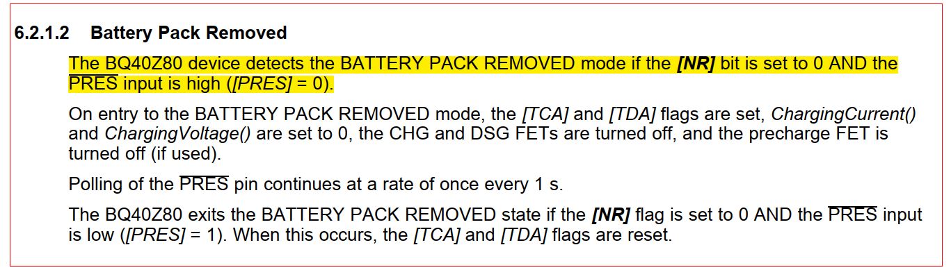

2) with a removable pack ,as the condition shows below,  a pack is in the BATTERY PACK REMOVED mode ,the CHG DSG FETs both off ,if press the DISP button on the pack, does the LED can display?I want make sure if a user can check the capacity of battery with a off system /stand alone status
    [Andy]  Yes. As I mentioned above, the LED display is available in SLEEP mode.  When the battery pack is removed, the gauge should enter the Sleep Mode.
