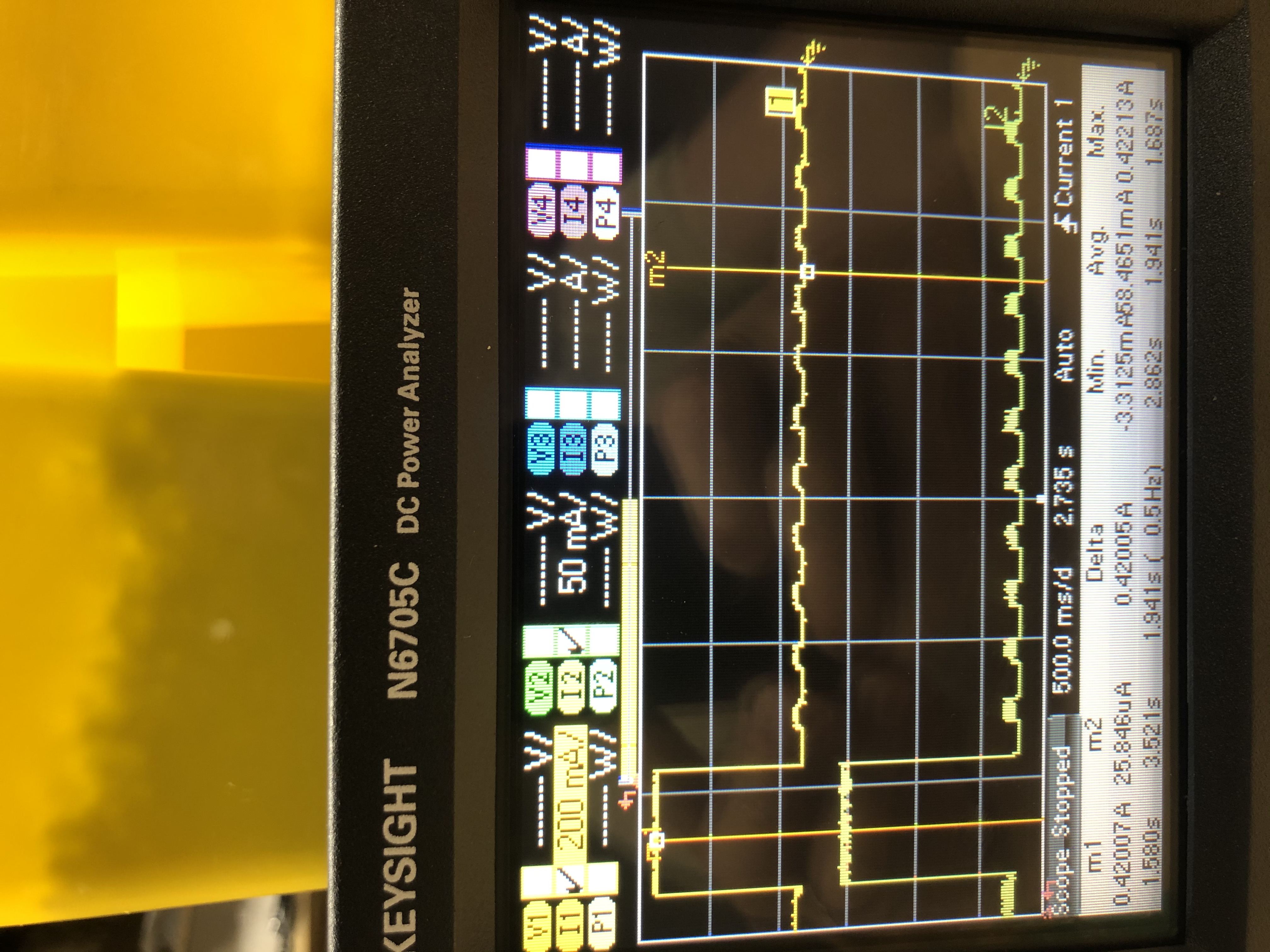

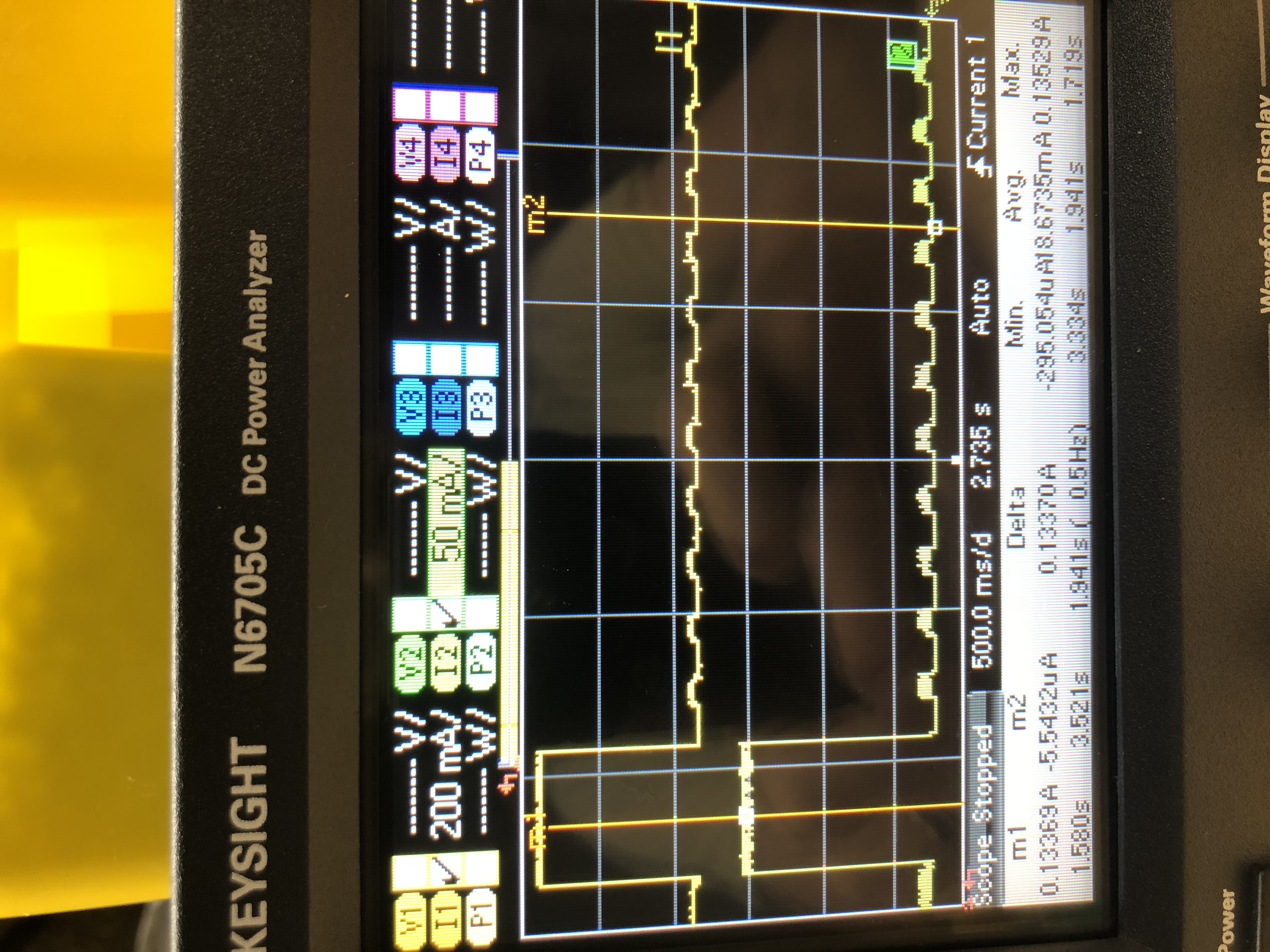

I've been evaluating a few different boost regulators for a new project and I'm confused by a few things I'm seeing.  When I look at the graphs the efficiencies of the regulator, they don't look that bad in the graph but when I measure the boosted pulses the current is higher than I was expecting.  Just for reference in this situation I am boosting what should be a ~140mA pulse at 3.3V.  I'm wanting to use a supply from 0.8V to 1.6V.  Below are the currents I'm reading with the TPS61021A boost regulator demo board.
310mA at Vin=1.5v
482mA at Vin=1v
576mA at Vin=.9V
659mA at Vin=.8V
745mA at Vin=.7V
If I look at the datasheet it says the regulator should be nearly 85% in this range.  It does start dropping off at higher currents but these numbers seem high.  My initial thought is that the efficiency is typically measured at a relatively steady state output and maybe the pulsed demand at the output is causing the regulator to have to compensate for the rapid change in demand at the load?
