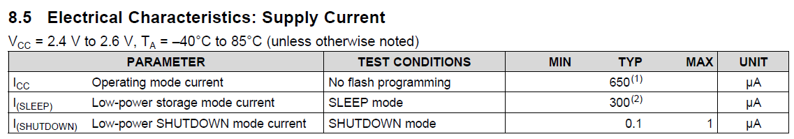

if the self discharge rate is same in operation mode and Sleep mode.
Compared with the self-consumption power consumption of Operation mode and Sleep mode, BQ78350 is more than doubled.
However, under the condition that the Self-Discharge Rate parameter value is the same and the storage temperature is the same, is the reduction in RSOC (RelativeStateOfCharge) of the unloaded storage in Operation mode nearly the same as the reduction in the RSOC of the unloaded storage in Sleep mode?

    When the device worked in difference mode, the whole system is in difference power consumption as well, the RSOC change will be different. the Self-discharge rate is regarding to the cell, that can't measured by the gauge.
