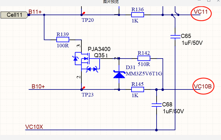

Hi team,
A customer use BQ76940 for E-bike. Some BQ76940 is broken when it connect to the battery. VC11 and VC10 was shorted.
When BQ76940 didn't download software, all the data is default. BQ76940 has a high failure rate.
Is BQ76940 have power sequence? Any document described this requirement? Here is the cell balancing circuit:
