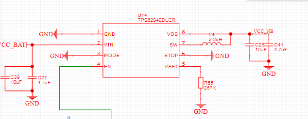

Customer has a question about tps62840. The topology is VBAT(2V~6V)-->TPS62840-->3.3V NB-IOT module.

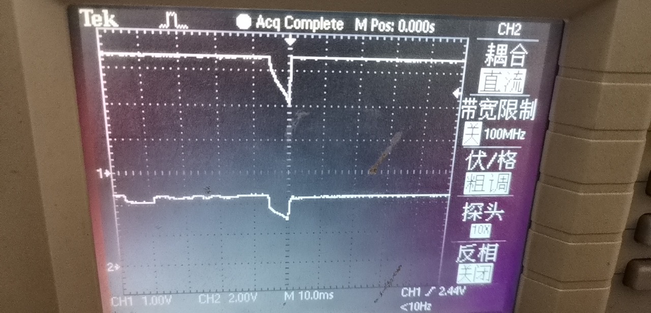

Customer found when battery in low capacity state, the voltage will change to 2V, then NB-IOT module will restart. And customer measured the input and output waveform when battery voltage drop, and the output voltage of TPS62840 will drop to 2V in 5ms. And the minimum working voltage for NB-IOT is 3.0V. I have attached the schematic and waveform, hope you could give some suggestion.
The NB-IOT could also work in 3.6V, but we may recommend TPS62842, so this is also one option for us.
