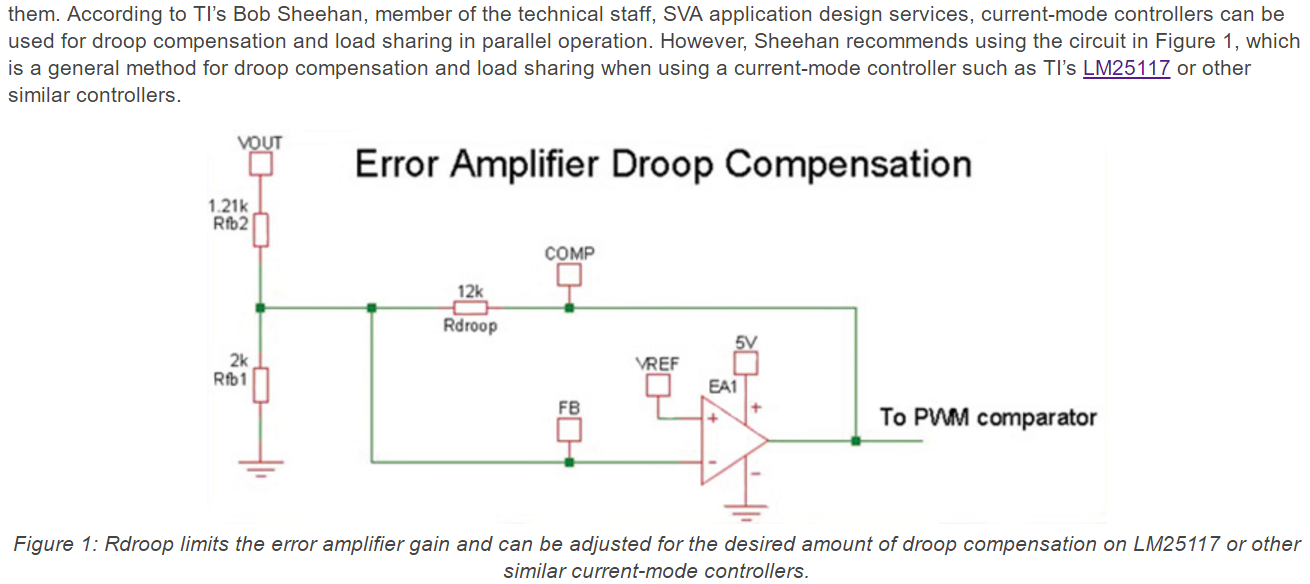

I read an article that introduced the method of droop compensation aimed at solving the problem of load sharing. But i don't know the philosophy behind the method, hence could not apply for other applications.
I want to find the original analysis related to this method of TI.

    FB node is virtual ground, then:
    Vout/Rfb1=Vcomp/Rcomp
    So Vcomp=Vout*Rcomp/Rfb1
    For peak current model control, Iout=K*Vcomp
    so Iout=Vout*K*Rcomp/Rfb1
    this means the Vout is proportional to Iout, this is essential feature for droop compensation.
    B R
    Andy
  • Correct typo:
    Vout/Rfb2=Vcomp/Rdroop
    So Vcomp=Vout*Rdroop/Rfb2
    so Iout=Vout*K*Rdroop/Rfb2

  • Hi
    With droop compensation, You need to evaluate load regulation or dynamic at point of load, NOT the output voltage on output cap close to converter.
    if you need more accurate output voltage at POL, you can adjust Vout by bias the FB node with output voltage or current of load current sense device. the converter control loop still has high gain PI integrator by this way.
