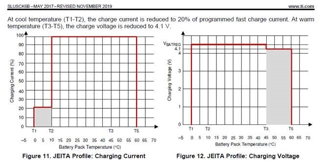

My customer tested the function of Charger JEITA. The ambient temperature is set at 48C. According to SPEC, the charging voltage will drop to 4.1V.

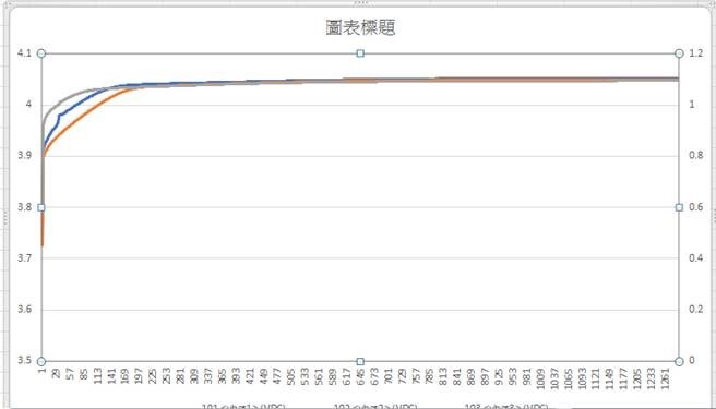

The actual voltage measured by the customer (as shown in the graph below) is about 4.05V, is this reasonable?
Does 4.1V have an error value? What is the error?
The customer put three BQ25606 circuit boards in the same temperature control furnace. So there will be three curves.
JEITA Charge measured battery voltage:
