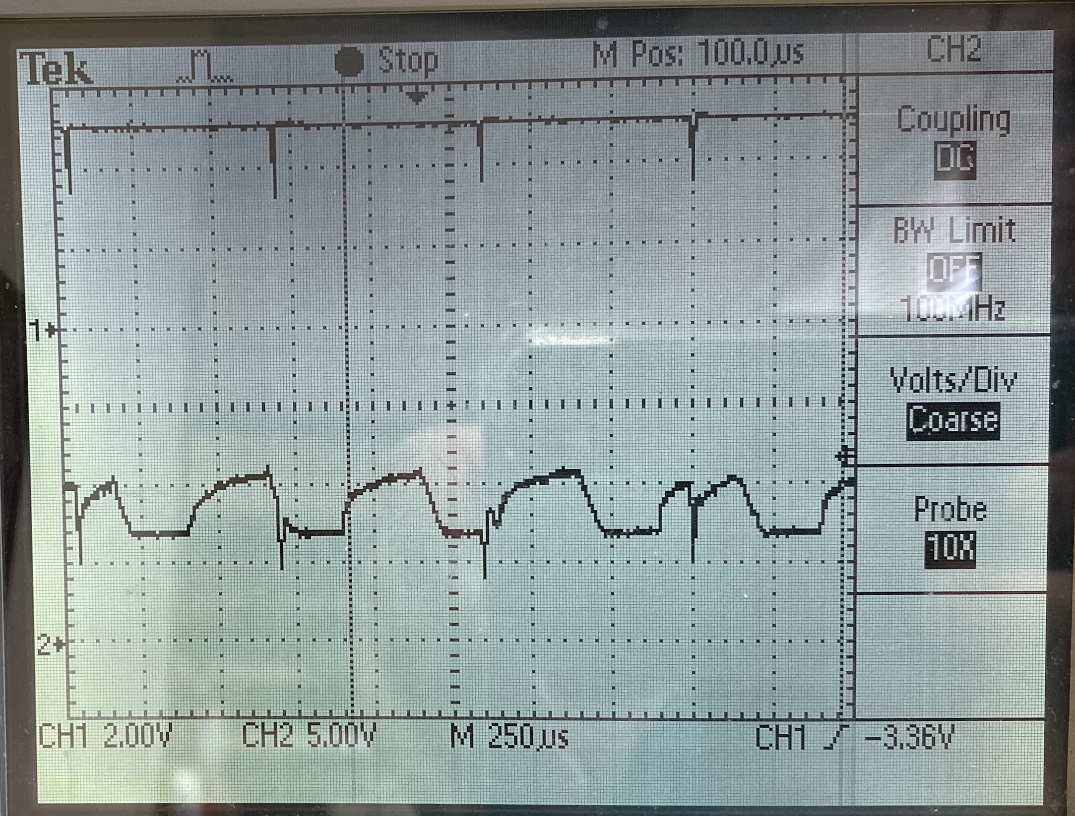

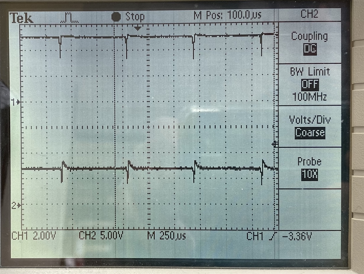

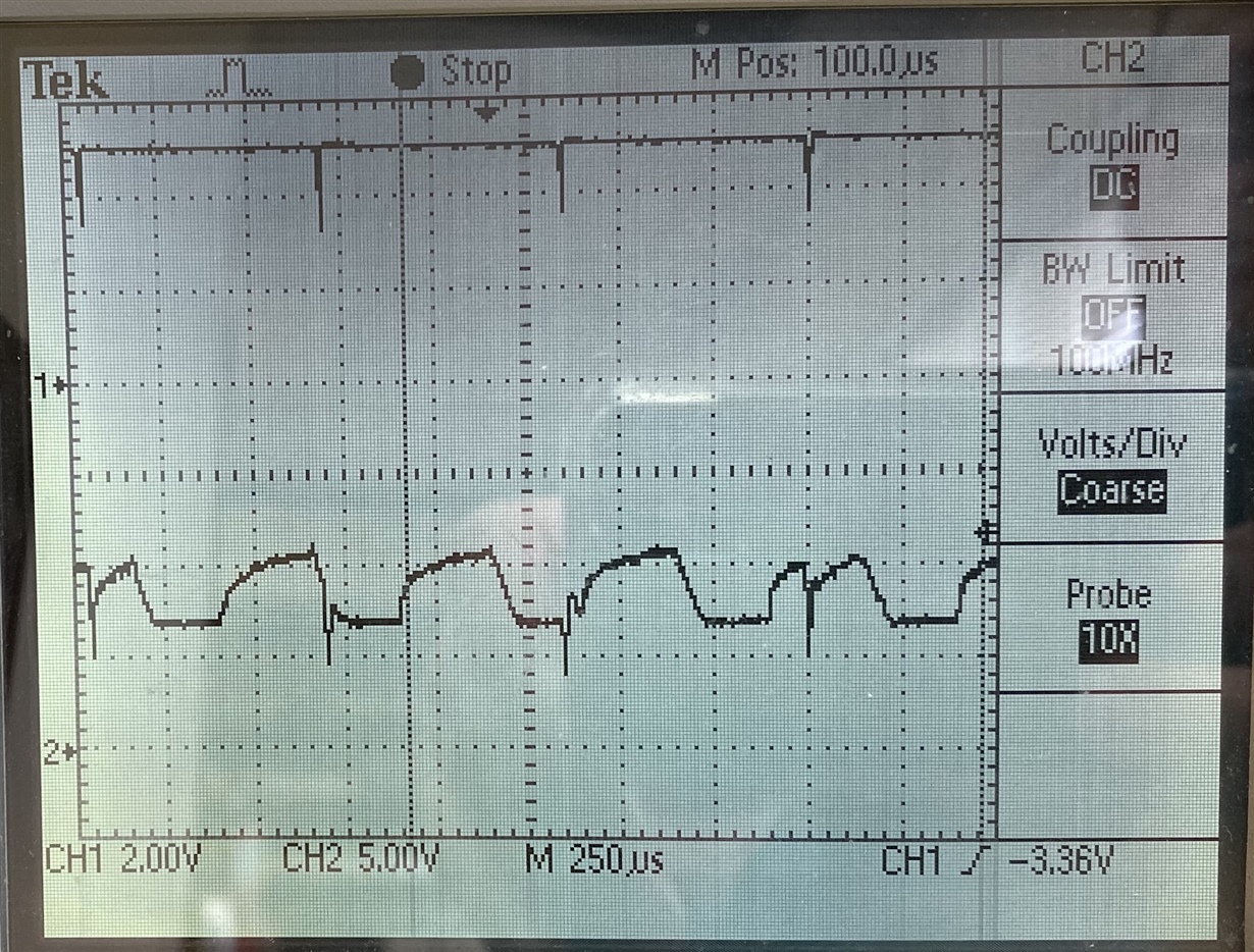

This is the result when I put a 200 mAmp load to the output.  The output starts to get these voltage drops spikes?
It does get more frequent as you add more load to the output.  Here I have 500 mAmp load and the output looks like this:
It Seems more frequent as I increase the load on the output.  The voltage does drop a little as to be expected when I increase the load, but the trouble I am having is how to remove these spikes.

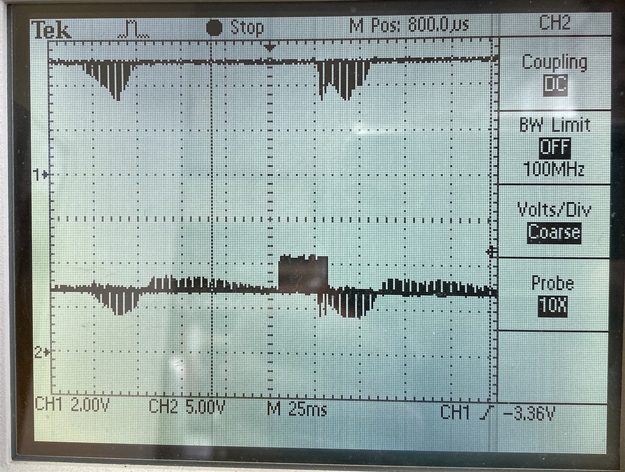

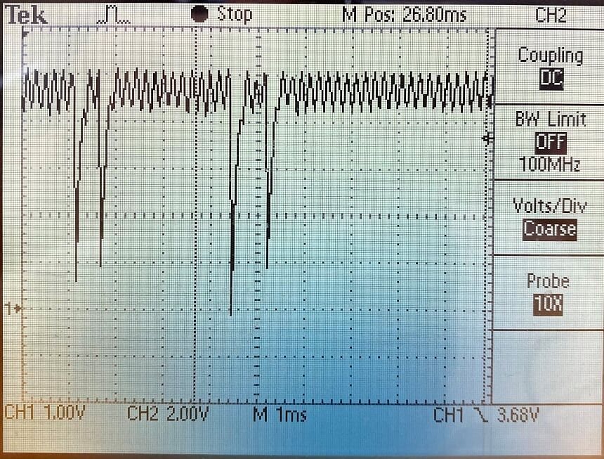

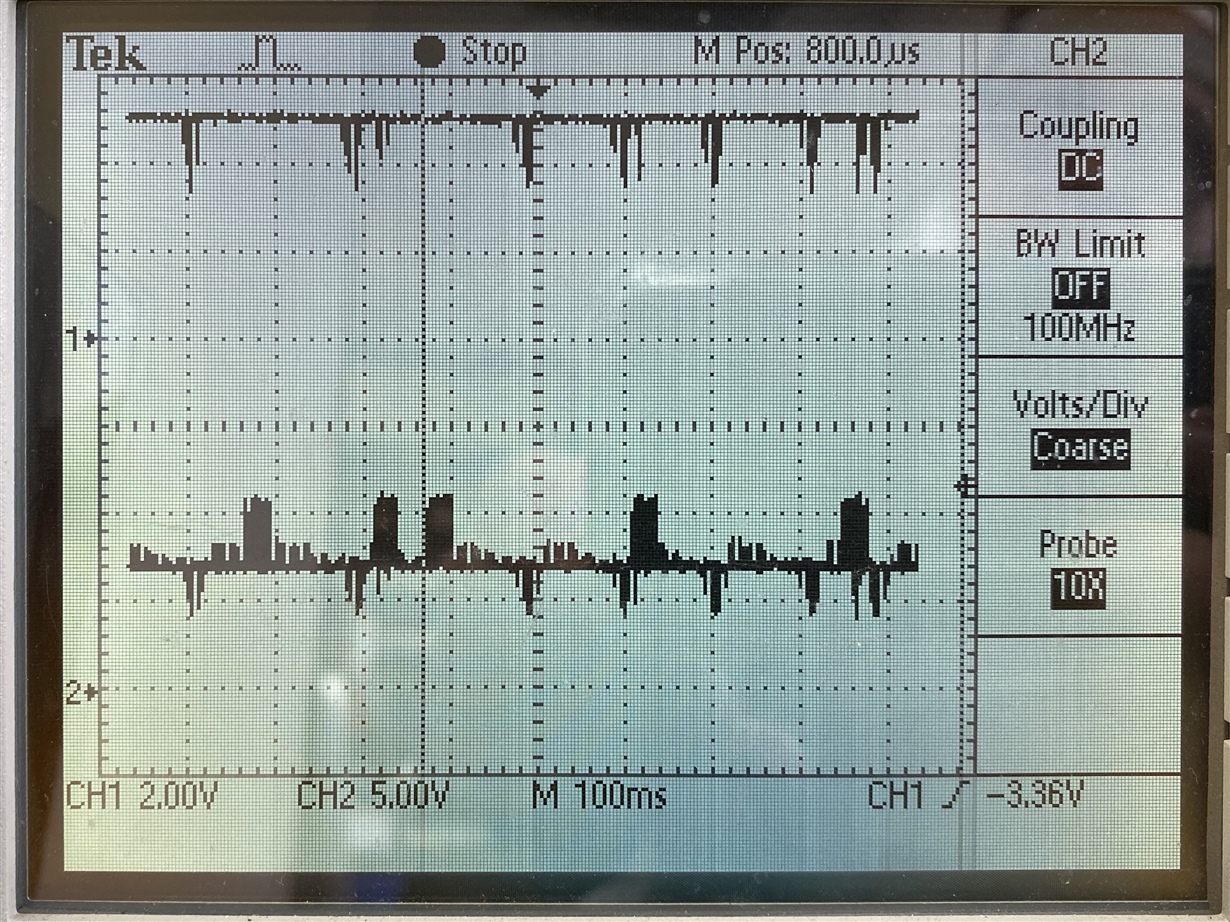

    Once again, thank you for your assistance to this project. I have replaced the two Capacitors of 33nF C4 and  C13 with a 22 nF cap as suggested and also removed R4 the 20K resistor.  Here is what Vout (CH1) on the top and RECT(CH2) on the bottom wave forms at 100 mSec  looks like now.
    I noticed that the Spikes on Vout have more drop and RECT has a higher Voltage.  I've taken faster captures of the same output, at different  time areas on this image.
    The above wave forms are taken with the circuit  connected to a Battery charger circuit which does not engage due to the UVLO circuit.  the Power spikes turns off the Battery Charger and it never really kicks on. I did put a constant load on the output and at 100 mA is has no problem, little if any power spikes shown, as I increase the load, the power spikes kick in.  The Load can go up to 1 Amp no problem, but lots of power spikes. See my previous Vout shoots.

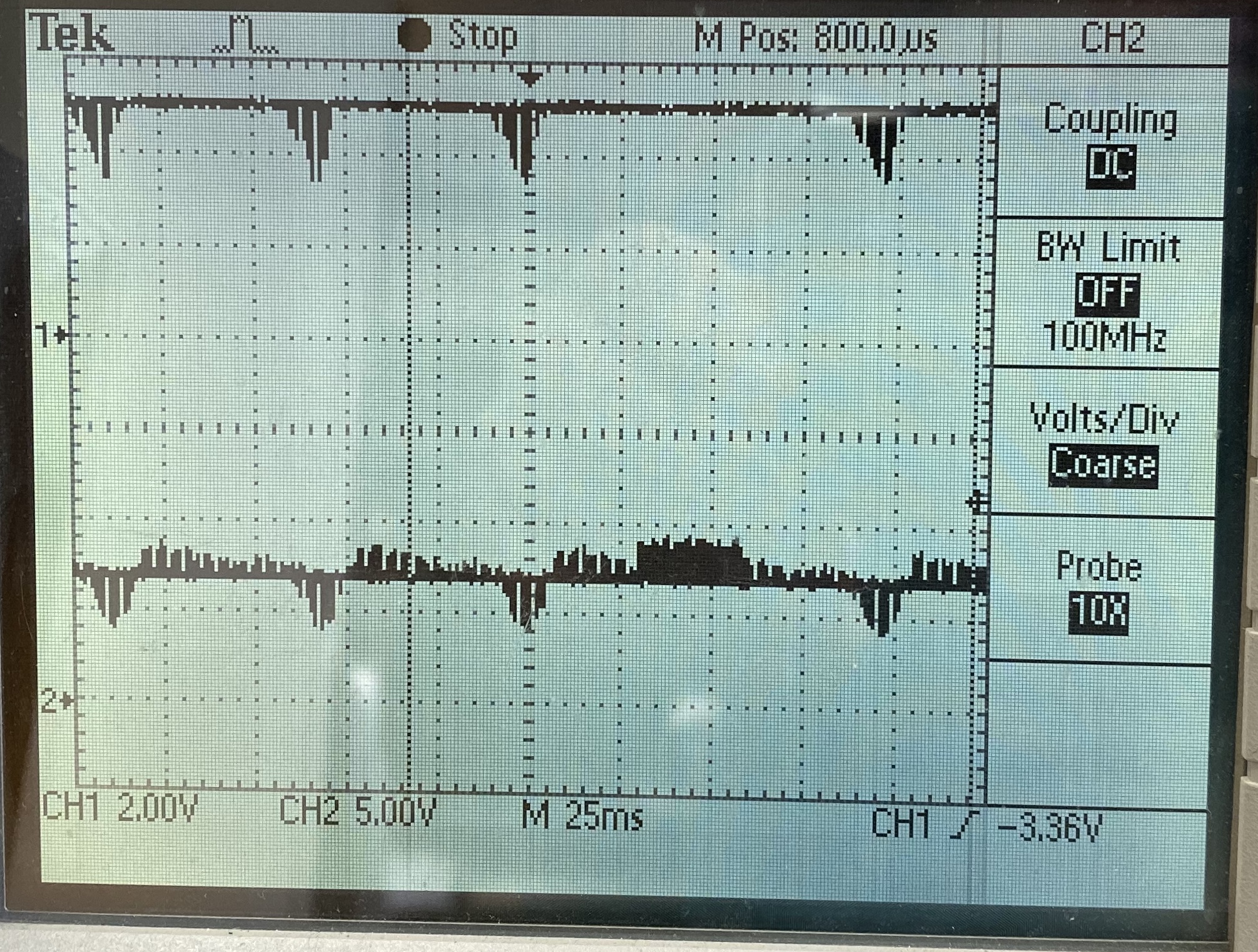

    The Snap shot below is Vout and RECT with the 33 nF caps and the 20K Resistor still on.  The spikes Voltage is less on RECT.
    Now I know you asked me to change ILIM.  Changing R3 or R2 or both?  I have two resistor ladder switch boxes in 1 Ohm increment 1% 1 Watt that I can use. Should I increase or decrease which resistors... What should the Max resistance be?  How should I go about this to start?  What load should I have on Vout?

  • Hi Steve
    The scope captures are showing a couple of things:
    1.)  The dip in VOUT and RECT are occurring at the same time.  Also the RECT voltage is at 7V indicating a light output load.
    2.) COMM pulse is not causing issues, the dips are not at that time.
    3.) ILIM setting is not an issue.  If it were we would see a dip at VOUT and not RECT.  --- R2 66 ohms and R3 196 ohms is OK for now.
    With a wireless system the load step needs to be supported by RX Coil, response time is to slow to change operating point.  We expect RECT to drop some during the load step but should be above 5V and output does not dip.
    Something to consider is the BQ51010B, this is a 7V output device that is P2P.  Can the charger accept 7V input?
