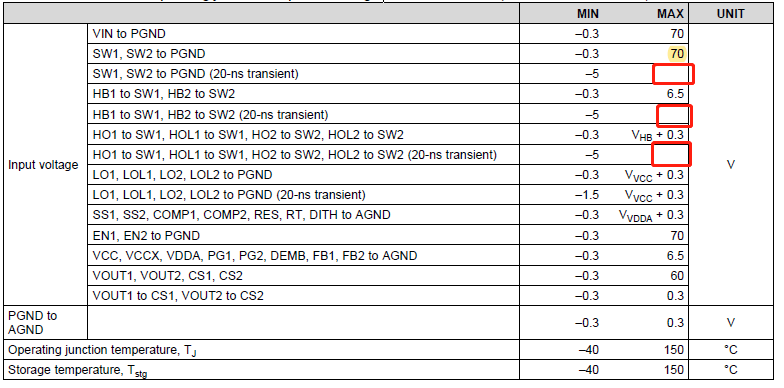

Hi team,
may have some question about LM5143-Q1 in 20ns transient value, as can be seen from datasheet, we did not show the value of 20ns transient value.
BR
Brandon.
Hi team,
BR
Brandon.
Hello
Based on input from the applications engineer for this device, there is
no data for the positive transient voltage spike. In this case the DC Abs
max specification is binding.
