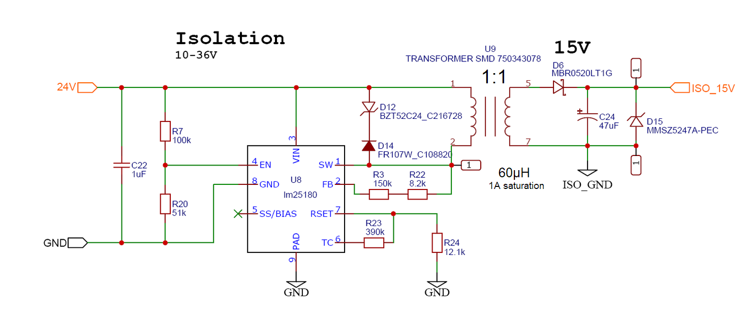

There is something wrong with the circuit but I cannot figure out what.
  • The expected output voltage is 15V but the output i have is unregulated and changes based on the input voltage. (When the input voltage is 12V the output voltage is 10V)

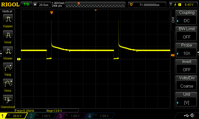

  • The switching frequency is stuck at 10-12 kHz. (It causes an audible high pitch)
  • When i add a load of 220 ohm the output stops working .
 I have the same behaviour with all 3 of the modules I made.
Can somebody help me?
Below is my schematic:
Below is the wave measured on the SW pin.

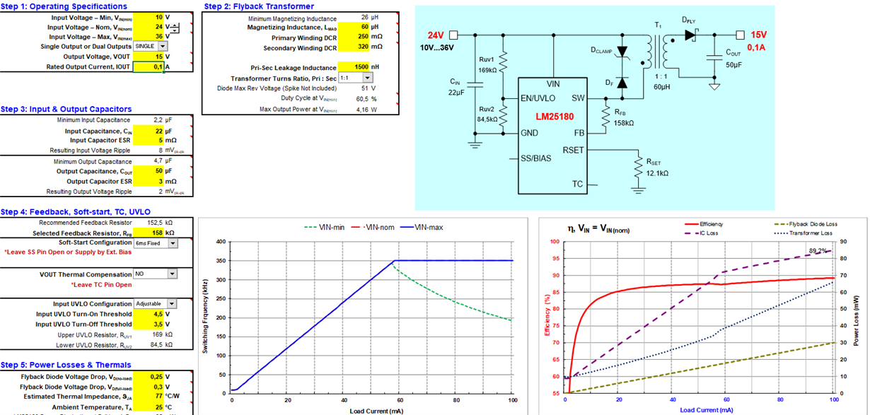

    Did you design the circuit based on LM25180 Calculator:
    http://www.ti.com/tool/LM25180DESIGN-CALC

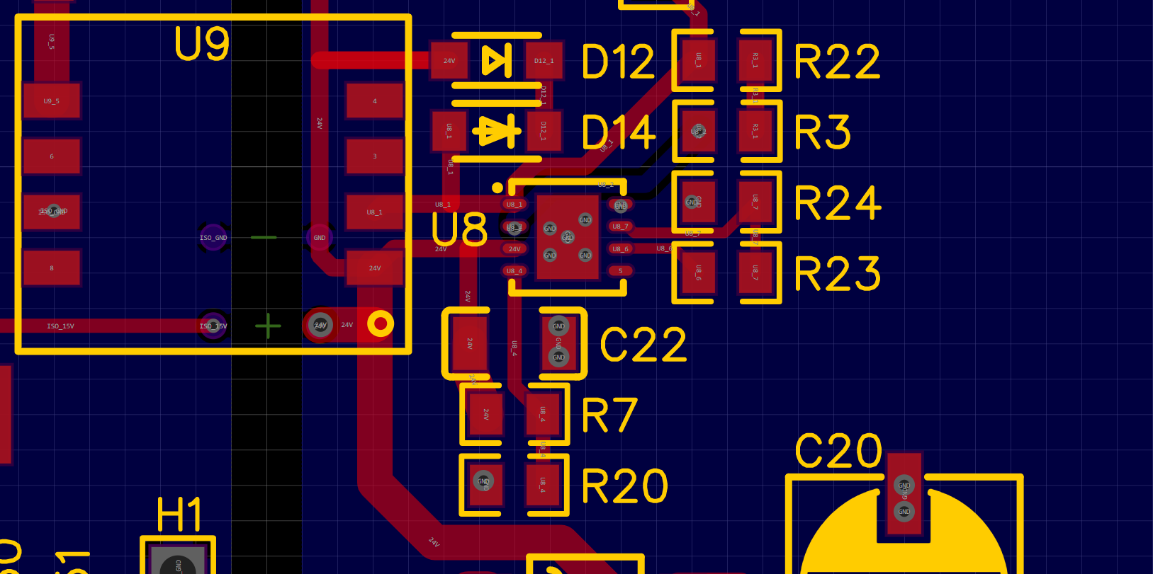

    Did you design the PCB layout by referring to LM25180EVM?

  • Yes I designed the circuit based on the calculator
    I did not follow the evaluation module for the evaulaution module. But i did try to make de high-frequency signal paths short and keep de capacitors close.
    I worked with a bottom grondplane, maybe that is the problem?
  • Hi Floris,
    The layout is not bad.
    Do you use MBR0520 on D6? this diode will block Vin-max plus Vout if XFMR has 1:1 ratio, so it should be 50V diode at Vin=24V, pls try it with 0.5A 100V diode.

  • Hi Floris,
    As Andy mentioned, the flyback diode should be higher voltage rating, either 60V or 100V (also depending on the leakage ringing). Also, the LM25180 has a peak current limit of 1.5A typical, hence why we recommend using a transformer with 2A sat current. In addition, 1uF is quite low for the input cap, try 10uF/50V.
    The output power is quite low here, 1.5W, so the LM5181 is generally more suitable (the peak primary current is 50% or 0.75A). In fact, the LM5181 is more aligned with your existing transformer with high mag inductance of 60uH and sat current of 1A. Take a look at the datasheet and quickstart calculator for that part - it is pin compatible with the LM25180.
