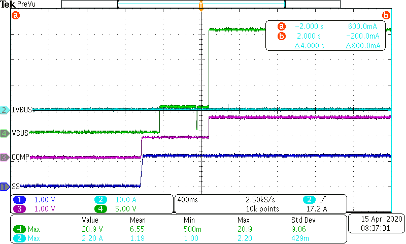

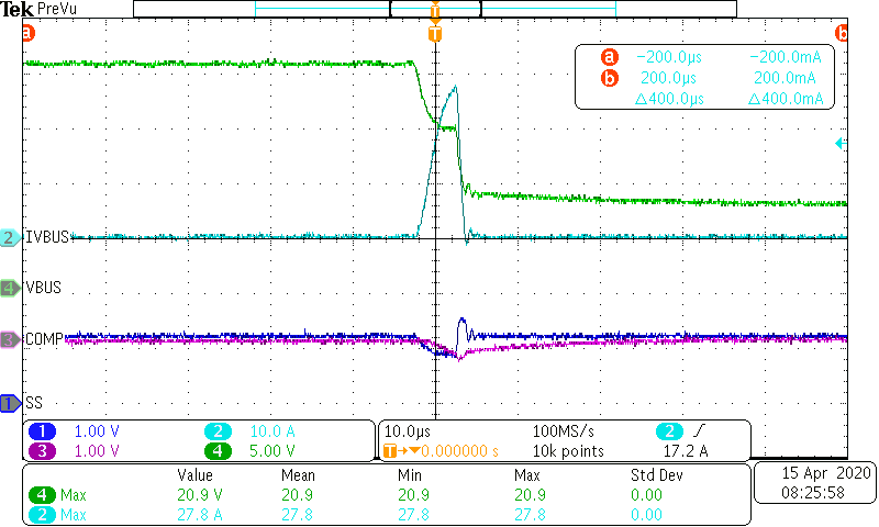

  we're run into a trouble for the output capacitor choose and confirm the RC network of comp pin of LM34936
becuase it's PD charge fail on Dell_5370(inrush issue,see the capture1) when using low ESR(30mR) capacitor or re-work the RC network(R683 to 3.3K ,C482 to 300pF of comp pin ,
special the temperature rise to 57°C,the issue  more terrible.

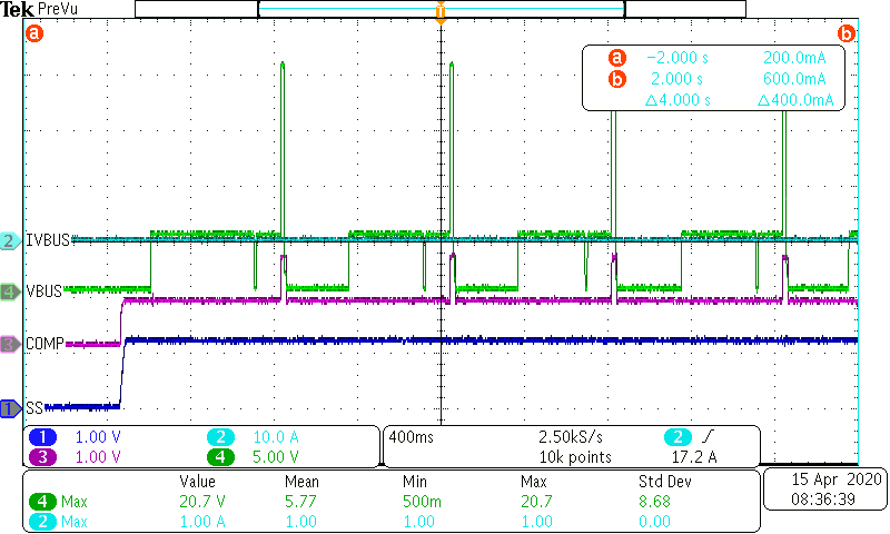

if change the E- capacitor(EC13 on our shcematic) to above ESR.150mR, the 5370 of NB charge normal.but the Y9000K(Y900K,20V/5A) fail(detail see the below captures)

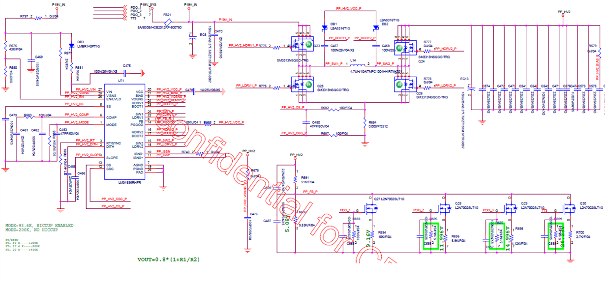

i tried tune the RT/SYNC pin and COMP pin on LM34936,but get the result didn't compatibility them(Dell_5370 and Lenovo_Y9000K).
as below circuit show to you reference.
kindly advise you give me some comment or solution for the issue.

5370 of Dell charge OK when using the E-cap of Higher ESR(above 150mR)
Y9000K charge fail when change E-cap of High ESR(above 150mR) on output power path.

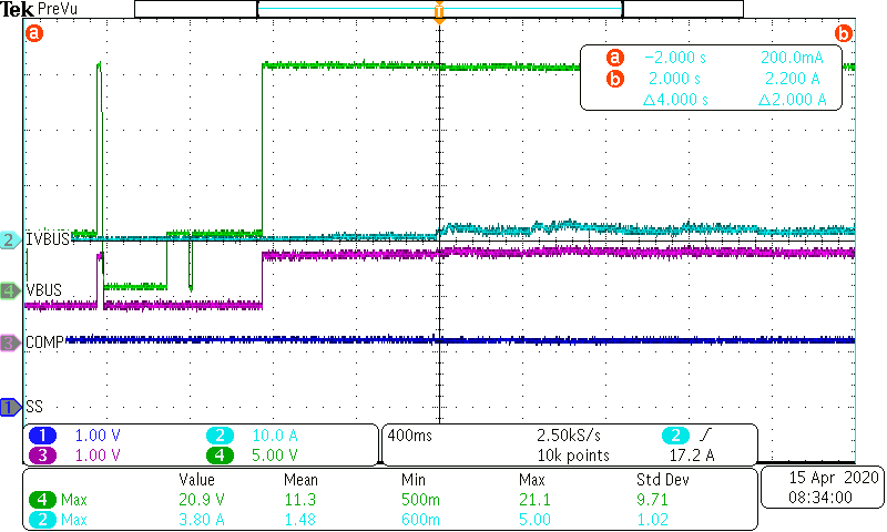

the Y9000K of NB charge OK when re-work the RC network of Comp pin of LM34936 and E-cap of Higher ESR(above 150mR)
   or change the E-cap of Lower ESR(30mR),it's same as effect(charge OK)

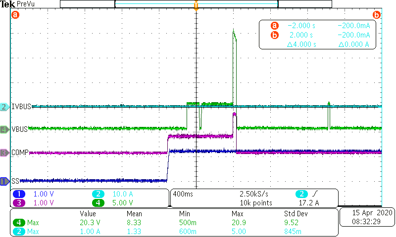

the 5370 of NB charge fail when re-work the RC network of Comp pin of LM34936 and E-cap of Higher ESR(above 150mR)
   or change the E-cap of Lower ESR(30mR),it's same as effect(charge fail)
