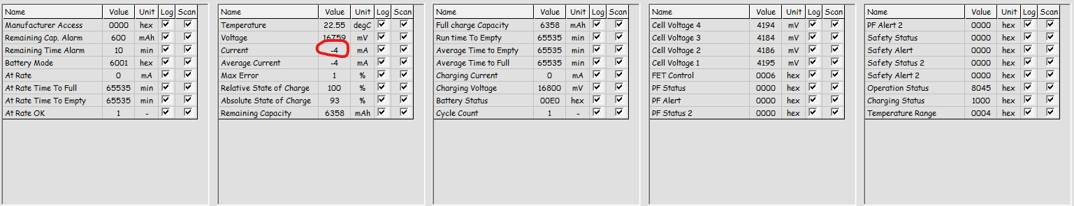

Hi team,
In standby a customer is measuring a small discharge current of about -4mA. They connected EV2300 to the battery to read the bq, is that the current into EV2300? Doesn't the current have to be 0 to not influence the capacity measurement / calculation ?
Franz
