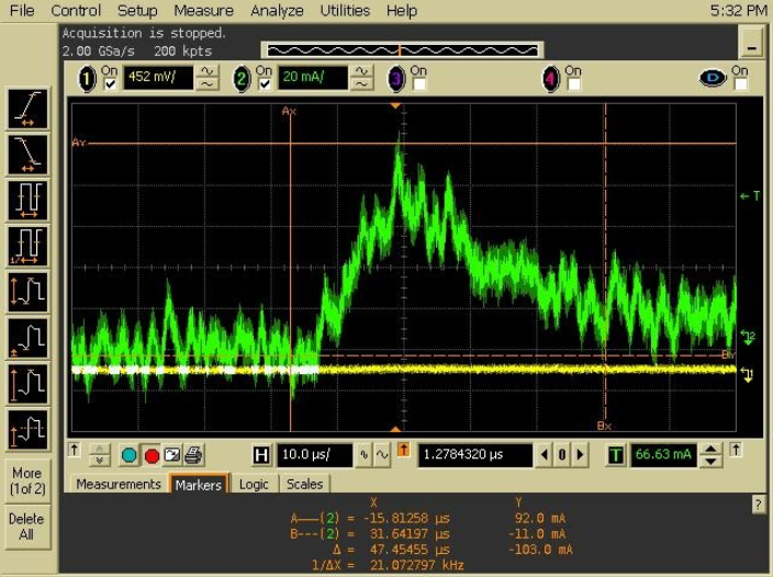

BQ35100: Sense resistor value check?
Part Number: BQ35100
The datasheet in the 8.2.2.5 Current Sense Resistor Selection says "The BQ35100 device calculates current through measuring a voltage across a small resistor in series with the battery. The default value is 100 mΩ. To maximize current measurement accuracy, the ideal value is calculated as:
RSENSE (mΩ) = V(SR)Max / Peak Load Current (mA)
Where V(SR) MAX = 125 mV"
I am concerned that we may not have a sufficient voltage drop to make this chip work correctly as we have a buck/boost converter between the battery and the comms module that  shapes the current we sample. We are transmitting for 80-100ms with ~190mA current sourced from the buck/boost and its Vout caps. The buck/boost will reduce this current value on its Vin input which is connected to the battery. What minimum voltage drop across the sense resistor would still work for the BQ35100 chip?  Shall we use an op-amp to boost the Rsense volage or stay with 100 mΩ ?
