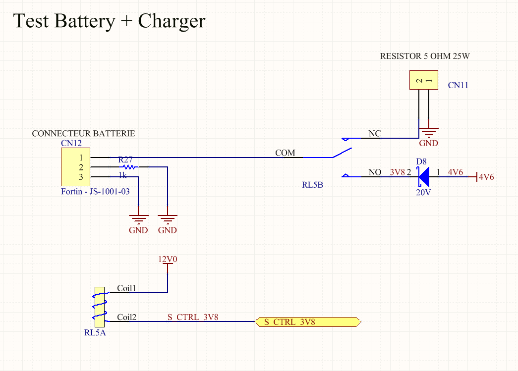

I would like to have a way to test our production PCBA without using a physical battery.
Is there a way to do a fake battery for QC test purpose only, and include this circuit into our test fixture.
I would like to power the PCBA by the fake battery and verify if the charger is working.
Having a real battery is complicated to protected it against PCB short-circuit and have a long term reliability.
I did this in the past to test a battery charger IC circuit.  Use a 2Ohm resistor to test the charger and supply 3.8v in the battery IC input.  1KOhm PIN 2 emulate the NTC resistor.
Any advice ??
