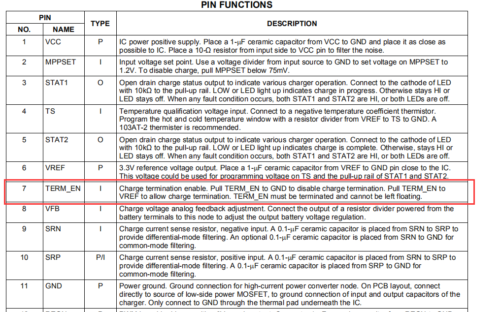

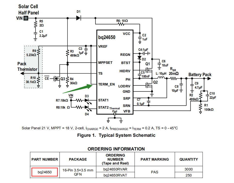

BQ24650: We want to use term_En control to turn off the charge. After actual operation, we find that it has no effect
  • Hi Kevin,
      The term_en pin cannot be used as a way to toggle to manually turn of charge. The purpose of this pin is to set high or low depending on if termination is required. Assuming termination is enabled through TERM_EN, then termination is detected while the voltage on the VFB pin is higher than the VRECH threshold and the charge current is less than the ITERM threshold (1/10 of fast charge current).
      Let me know more details of your issue and test setup if you are having issues terminating.
