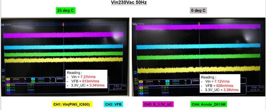

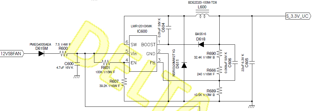

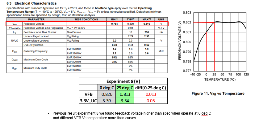

may i have your comments about the side effect of CFF capacitor (C606) on upper feedback resistor?
my customer was encountered FB pin out of SPEC under low temp, but after shipped the suspect IC back to TI, it's passed ATE and bench,
i assumed the issue was caused by CFF capacitor, may i have your deep explain on this cap?
