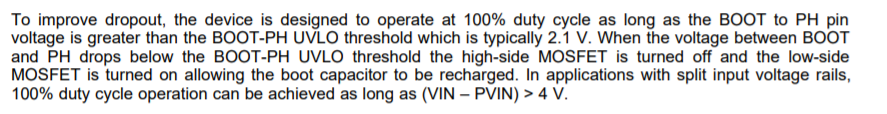

TPS54620: Maximum Duty cycle When VIN=6.1V, VOUT=5.5V, Fsw=650k
Part Number: TPS54620
HI Team,
My customer wants to use TPS54620 for 6.1VIN->5VOUT, 650kHz. The description in datasheet about low dropout operation does not state it clearly when PVIN=VIN. So, could you please help check the feasibility for TPS54620 in this operation state?
