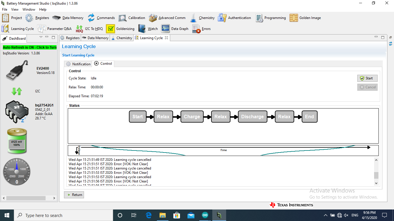

I am getting an Error: VOK not cleared during the Battery Learning cycle and the cycle was cancelled.
Cycle started with Discharge-Relax-Charge-Relax- (ERROR: VOK not Cleared and cycle stopped)
In the Bqstudio, Register status VOK is LOW after the relax. But still the error was VOK not cleared after relax and because of this the cycle was cancelled.
I am attaching the screenshots for your reference. Kindly suggest me the answer for this.
Thanks in advance.
Shambavi

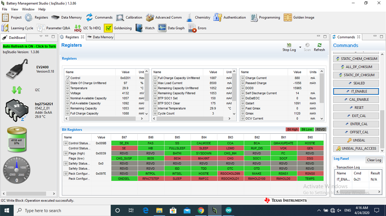

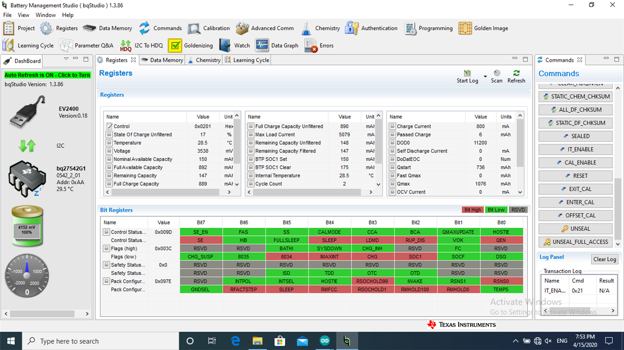

  • Hi Andy,
    I followed your manual for my learning cycle.
    Charging was completed when the battery reached 97%, the voltage was 4132mV and the FC bit was NOT set so not able to complete the learning cycle.
    Initially Maximum battery voltage was 4200mV, since the charging was not reaching to 100%, we changed the maximum battery voltage to 4100mV and tried again, But still battery voltage is not reaching to 100% and FC bit is not set.

  • The Taper Current is set to 100mV in your gg file.  The AvargeCurrent() needs to be less than the Taper Current setting for two consecutive periods of Current Taper Window (40s), in order for the FC bit to be set.
    In your log file, charging stopped when the AverageCurrent() was106mA. I would suggest you keep charging until the FC bit is set.
