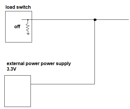

Hello.  I'm using the TPS22965 as both a load switch and for isolation when connecting an external supply.  The external supply voltages (4 switches) will be 3.3, 2.5, 1.8, and 1.5V.  I'm concerned that this part has an internal output load resistor which will consume power (14mA for the 3.3V case).

    The condition I’m asking about looks like the following.  The Load Switch is in the off state and an external 3.3V power supply is on.
    When the switch is disabled, the QOD resistor will be active and will sink current from the output. Is the QOD a feature that you would need in your application?
    If the QOD functionality is not needed you can use the TPS22965N which is the same device, but without QOD. A thing to keep in mind is that the TPS22965 does not have reverse current blocking and a voltage VOUT>VIN could potentially damage the device.
