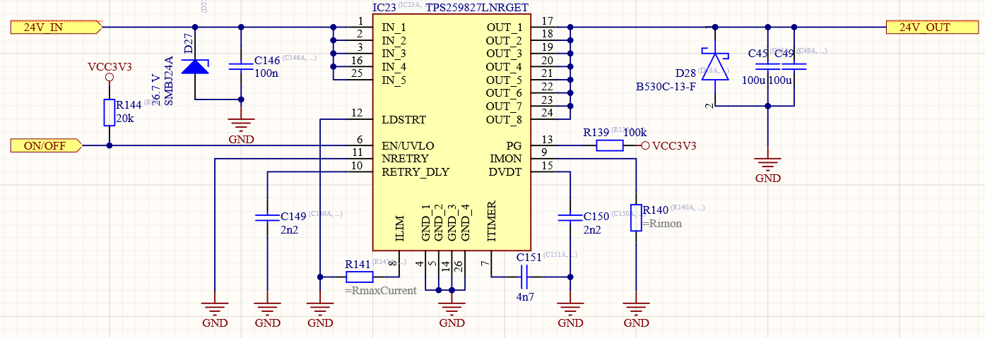

    Schematic is following:
    Where RmaxCurrent is ~250R (270R probably) and Rimon is 2k2.
    For Cdvdt = 2n2 fuse powers up with max 0.8 A current load. It's not enough. In the table on p.9 in datasheet margins are wider. In the excel file I'm setting 10R load at start-up. Anyway, I minimized dvdt time (removed C150) and here we have another problem. As you can see, I'm trying to control EN line from MCU. When I'm setting low state (connecting to GND) on this pin during efuse operation with some load, after reset try, it destabilizes and falls into infinite reset cycles. I'm getting voltage on the output only if I turn off the load.

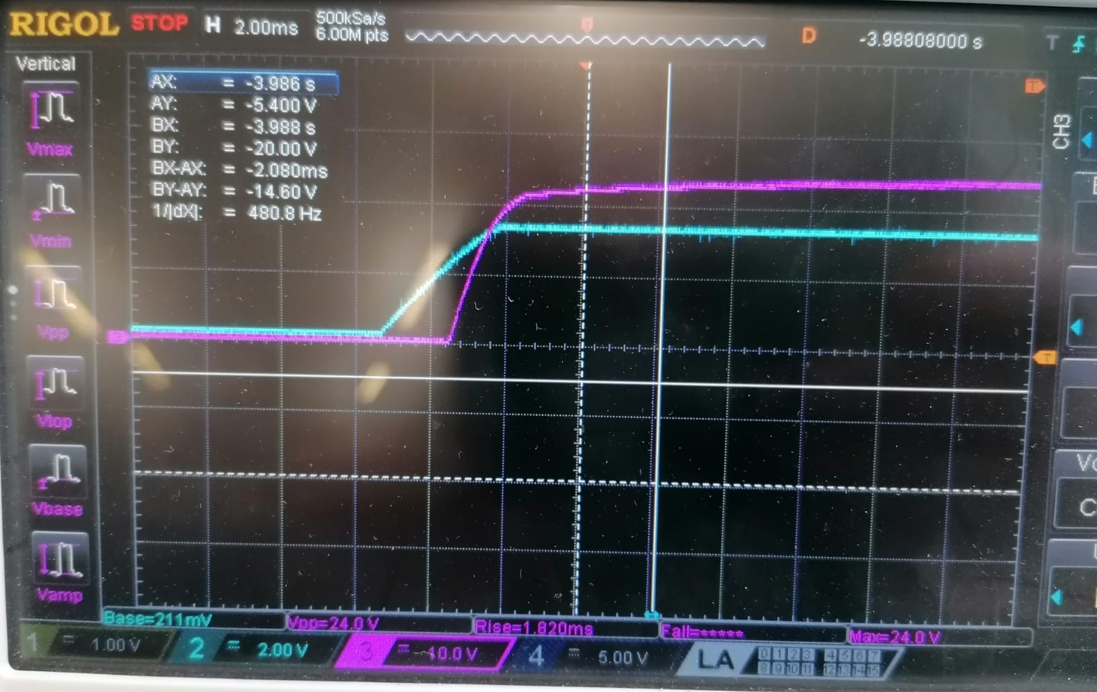

    Here is efuse power up with no load (blue - EN pin, pink - output voltage):

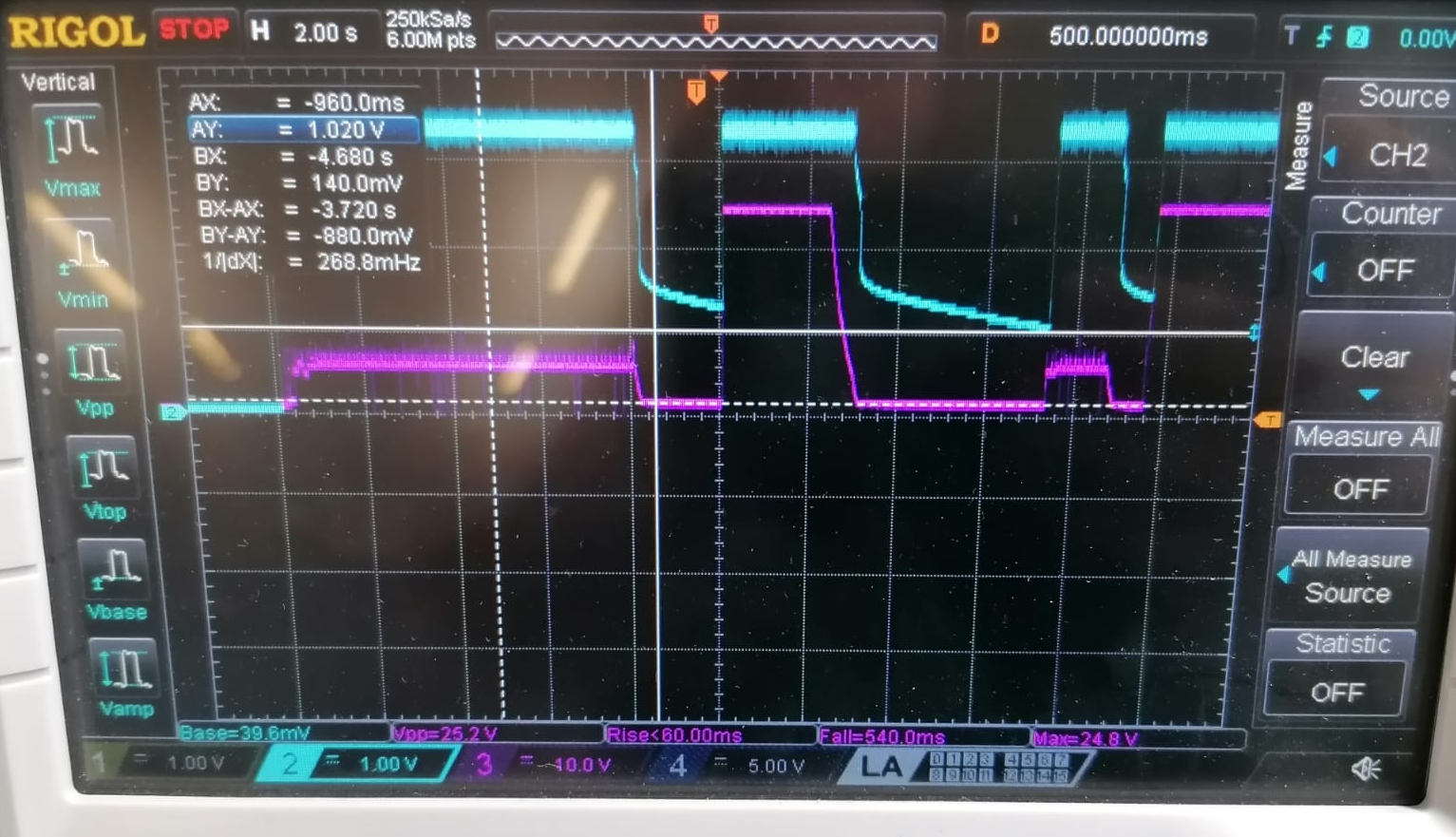

    I thought the problem can be with the external 3V3 source (it's coming from DC converter which is powering from 12V, which in turn come from 24V). I've noticed that if I turn off 24V power supply and turn it on fast enough (so supply on EN pin won't fall under ~1.2V) efuse will power up with load. Below is oscillogram.
    Second channel div is 1 V (EN pin) and third one 10 V (output voltage). First rising edge is the first PCB start-up - fuse is resetting all the time. I'm turning the power supply off and turning it on fast - fuse works fine. The third rising edge shows the situation when I let 3V3 on EN pin fall too much - efuse is resetting again. It doesn't make any sense - how EN function suppose to work if I can't set low state on this pin (<1V2)?

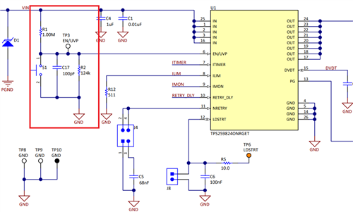

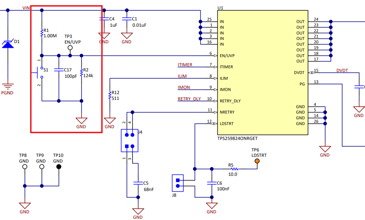

    I was trying also to use a voltage divider instead of using external 3V3. According to your eval board schematic it looked following:
    I've changed R2 to 60k, so EN voltage was ~1.35V. When I was switching line to GND to reset fuse, it didn't power up correctly and was resetting infinitely, again. Still under the load of course.
