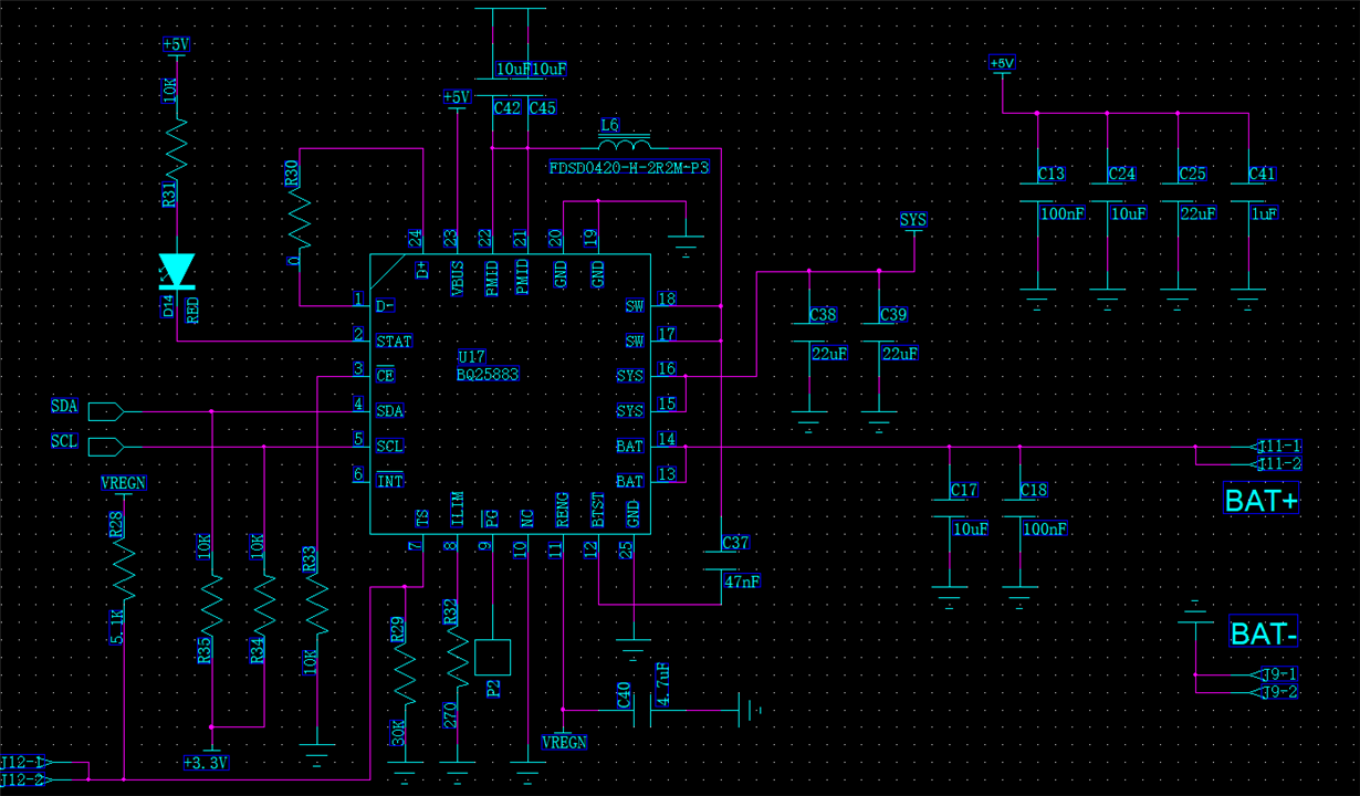

using bq25883 charge two-cell li-ion battery(7.6V)
adapter :5V, 2.4A
setting as below:
charge current:1A
d+ short with d-
input current limit: 3A
result:
charge current:660mA
REG:0x0B   VALUE:0x23
Can you tell me the reason?Why does the charging current fall short of expectations

  • hi michael,thanks for your reply.
    the schematic is designed ref the demo.
    1st: the adpater can provide the rated current.(Simulate adapter with DC power supply)
    2nd: if set the vindpm 5v      reg 0B value:0X23  indicates enter VINDPM regulation
            if set the vindpm 4.3v   reg 01  value:0x94  indicates enter HIZ

  • The adapter voltage is 5V
    When VINDPM is set to 5V, it can be charged, but into VINDPM REGULATION
    When VINDPM is set to 4.3v, go directly to HIZ
  • In order to further diagnose this problem, I would appreciate if you could provide the schematic you are using. In addition, I would like a waveform of IBUS, VBUS, SW, and IBAT. I would like you to trigger on the edge that VBUS goes high for each setting of VINDPM. The part appears to still be in VINDPM from the registers you provided.
    Mike Emanuel
    Please click "This resolved my issue" button if this post answers your question.

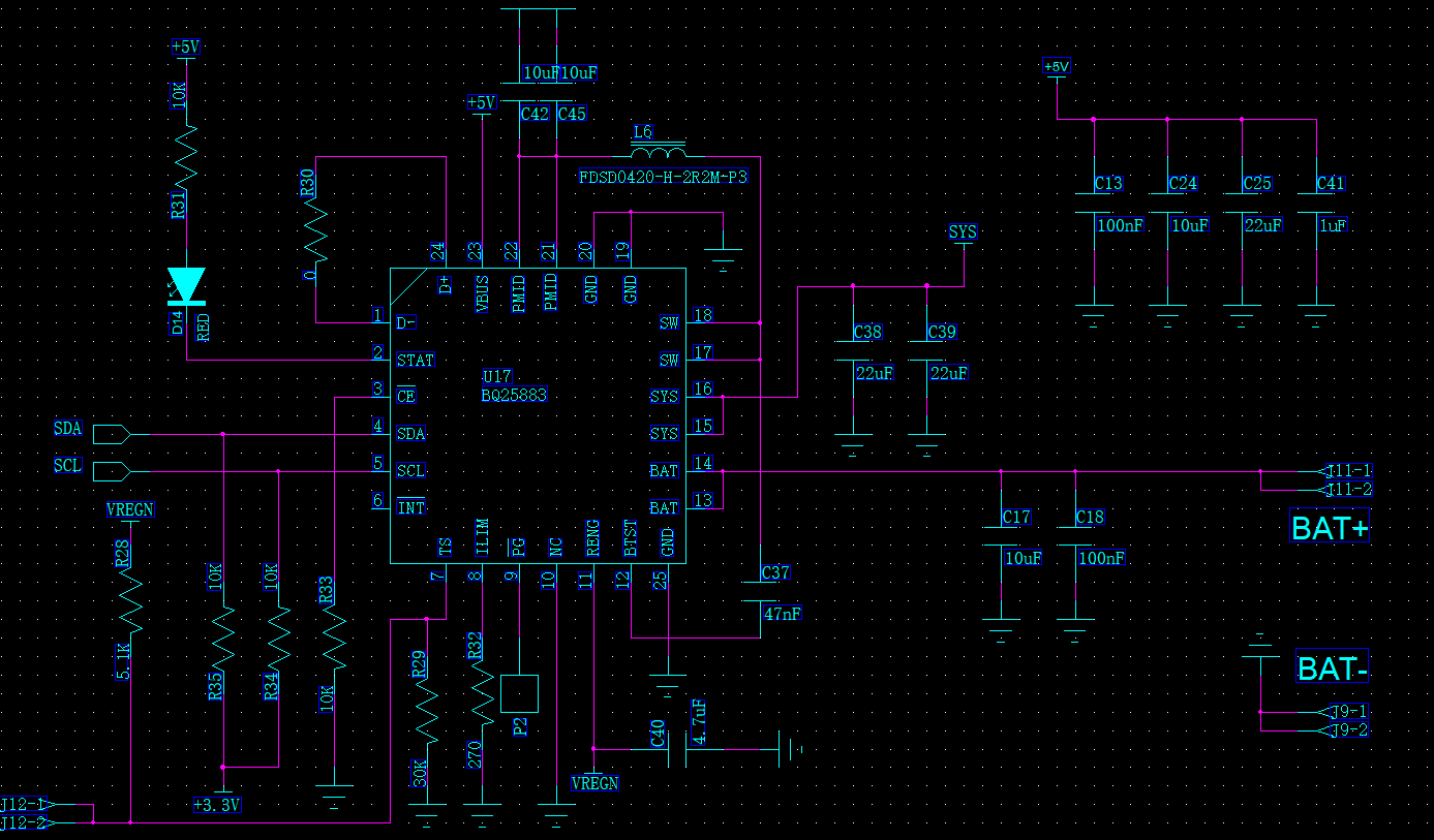

  •  THE SCH IS SHOWN AS ABOVE:
    THE BQ25883 is used only as a battery charger.
  • If you could provide some waveforms (IBUS, VBUS, SW, and IBAT upon startup) for each case of VINPDM that would be helpful. Upon second look at your register settings, 0x80 in REG 0C indicates Power Good with no input. For some reason your input is not being detected.
    How long is your input cable (more specifically what is its impedance)? To me, if VINDPM is 5 V, which is your adapter rated voltage, it can pull some of your desired current, but maybe not all because of the impedance of the cable. When you try to pull the desired current at VINDPM of 4.3 V, you may be crashing the adapter.
