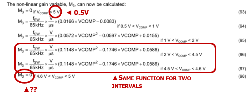

I recall this old discussion for which no answer was given regarding the nonlinear gain parameter M3 introduced and calculated in the datasheet.
Its origin is particularly mysterious: I would like to point out two critical points:

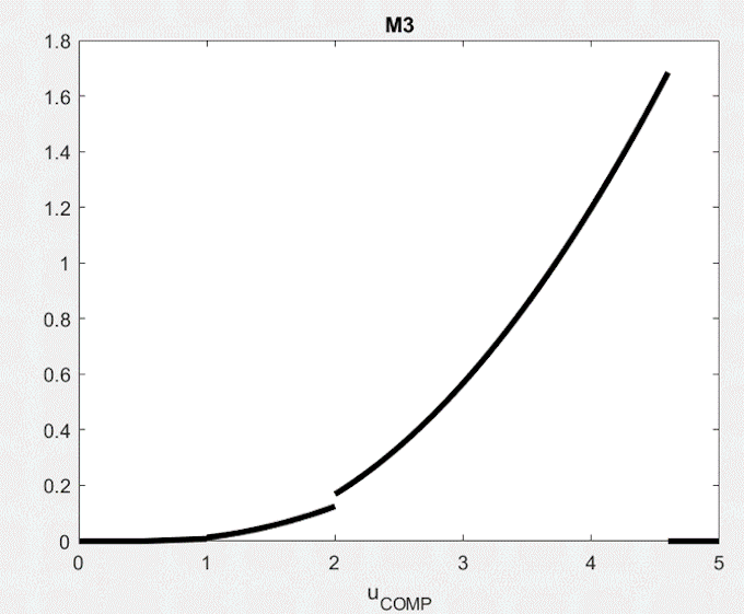

The piecewise interpolant function reported in datasheet (latest review D)  / application notes seems to be totally wrong.
See following pictures:
The plotted PW Function M3(V_COMP)
I would not agree at all with the transfer function reported in datasheet.
This point is the most important one. Unfortunately, to clarify my question, I'll have to go into a brief mathematical discussion of the PFC. Since is not an easy task to accomplish by writing in plain text, I've prepared a PDF document...I'd appreciate it if you could take a look at it.
2870.TI_ucc28180.pdf
Thank you in advance.
