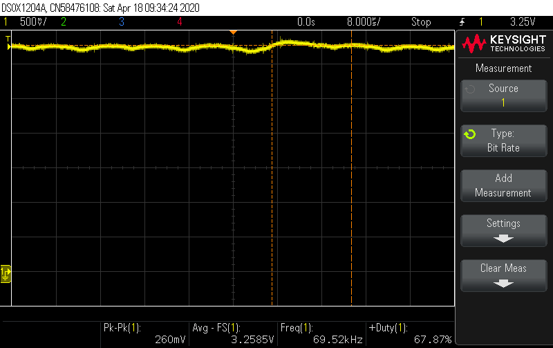

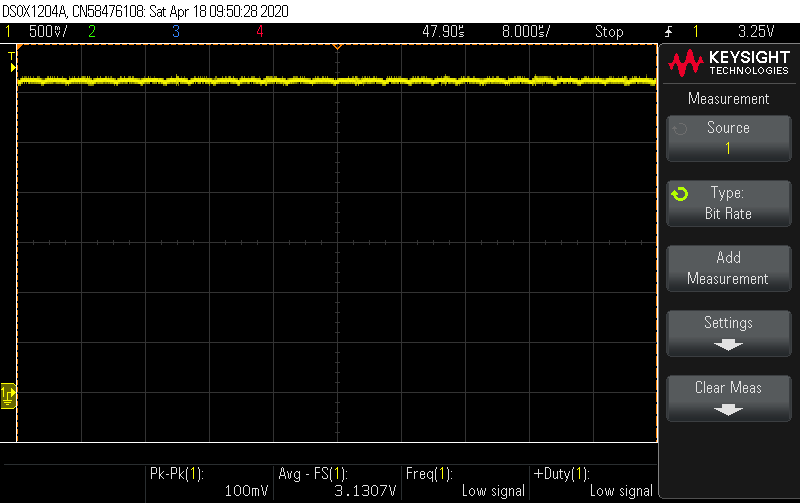

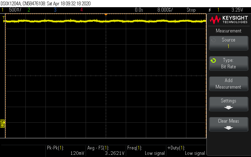

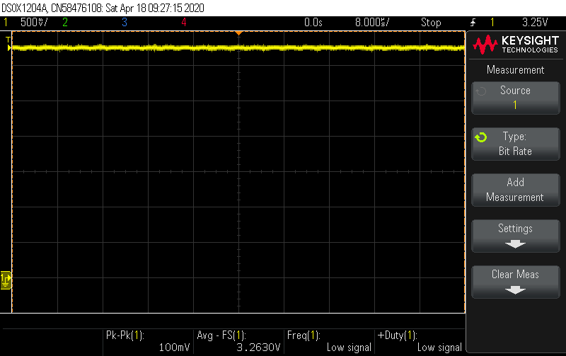

From VIN = 4,3V-8,5V everything seems good. VOUT and SW looks reasonable. VOUT = 3,26V and 100mV peak-peak ripple (could be better according to simulations).
Image 1: VOUT @ VIN = 8,4V

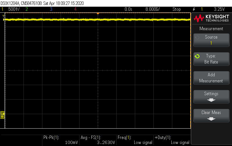

Image 2: SW @ VIN = 8,4V

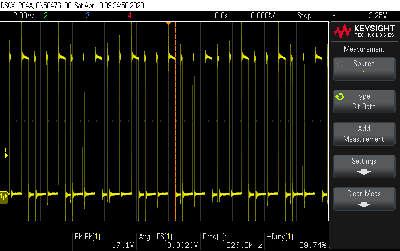

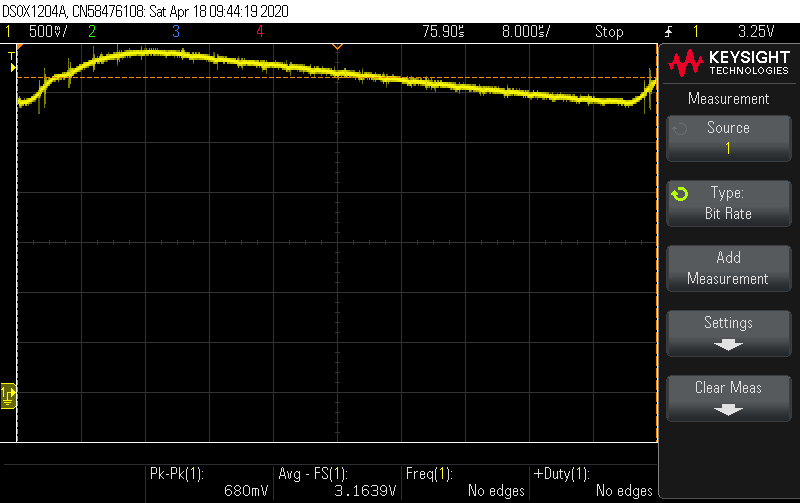

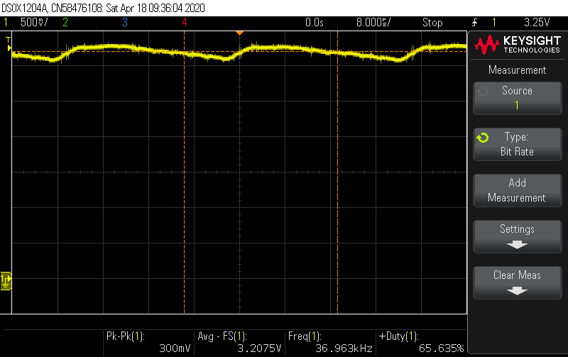

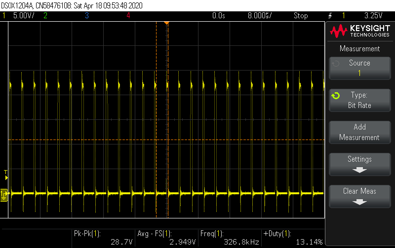

Raising VIN seems to increase ripple on VOUT and SW begins to look wrong.
Image 3: VOUT @ VIN = 8,7V
Image 4: SW @ VIN = 8,7V
Image 5: VOUT @ VIN = 11,7V
Image 6: SW @ VIN = 11,7V

As you can see ripple increases significantly.
This proceeds until VIN = 20,4V. Around 20,4V a very high audible noise occurs. Above this, the signals look nice again, and power consumption drops to ~50% just after the signals look nice again.

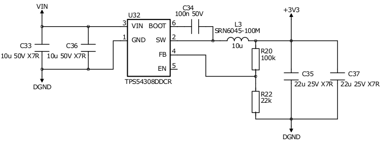

This is mounted on a PCB from a PCB manufacturer.
I have double checked all solderings and on a second board manually double soldered all solderings.
This issue persists across 3 different prototypes.
See below for schematic and PCB of circuit.
Image 15: Schematic of circuit.
Image 16: PCB layout of circuit.
