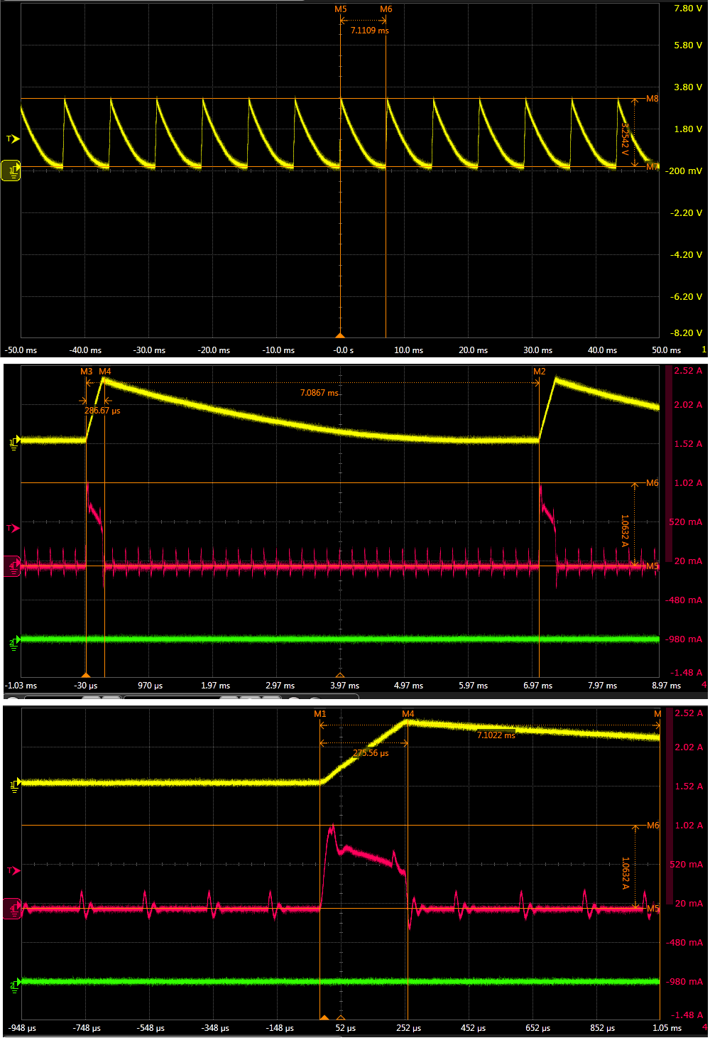

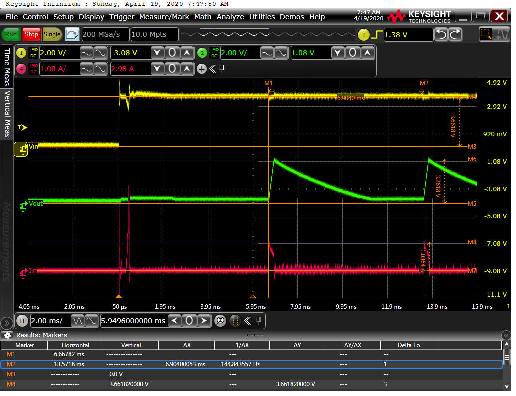

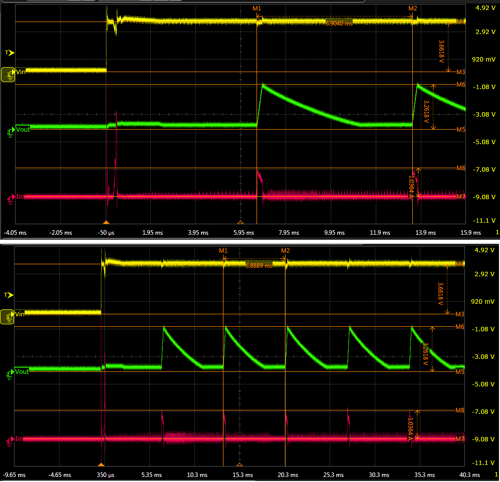

The circuit is implemented exactly like TPS61280EVM Schematic except that EN, nByp and Vsel are connected to Vin,
It will not start to work through all the input voltage range
Tests done with load, small load and no load at all, results are the same
Any suggestions why the TPS61280A does not start to work
