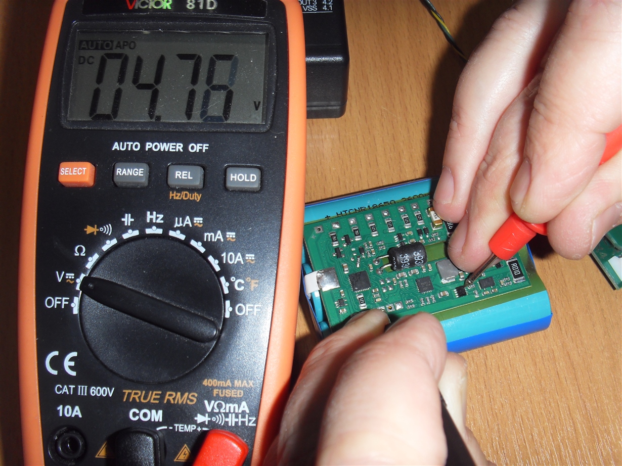

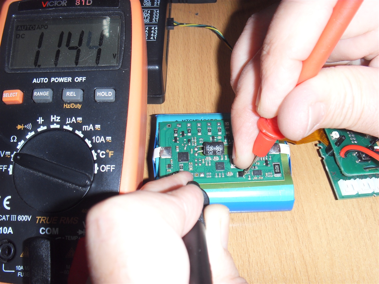

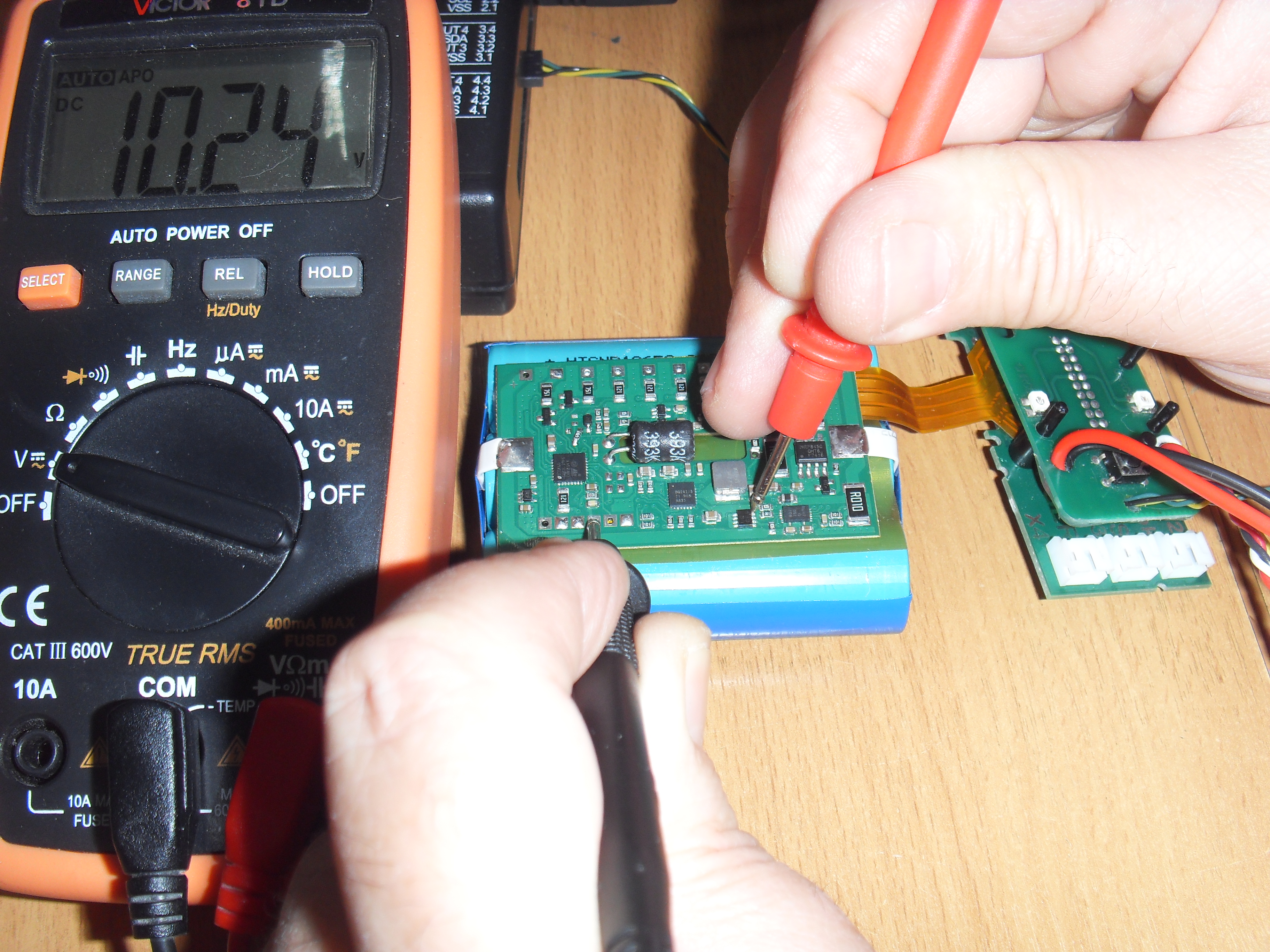

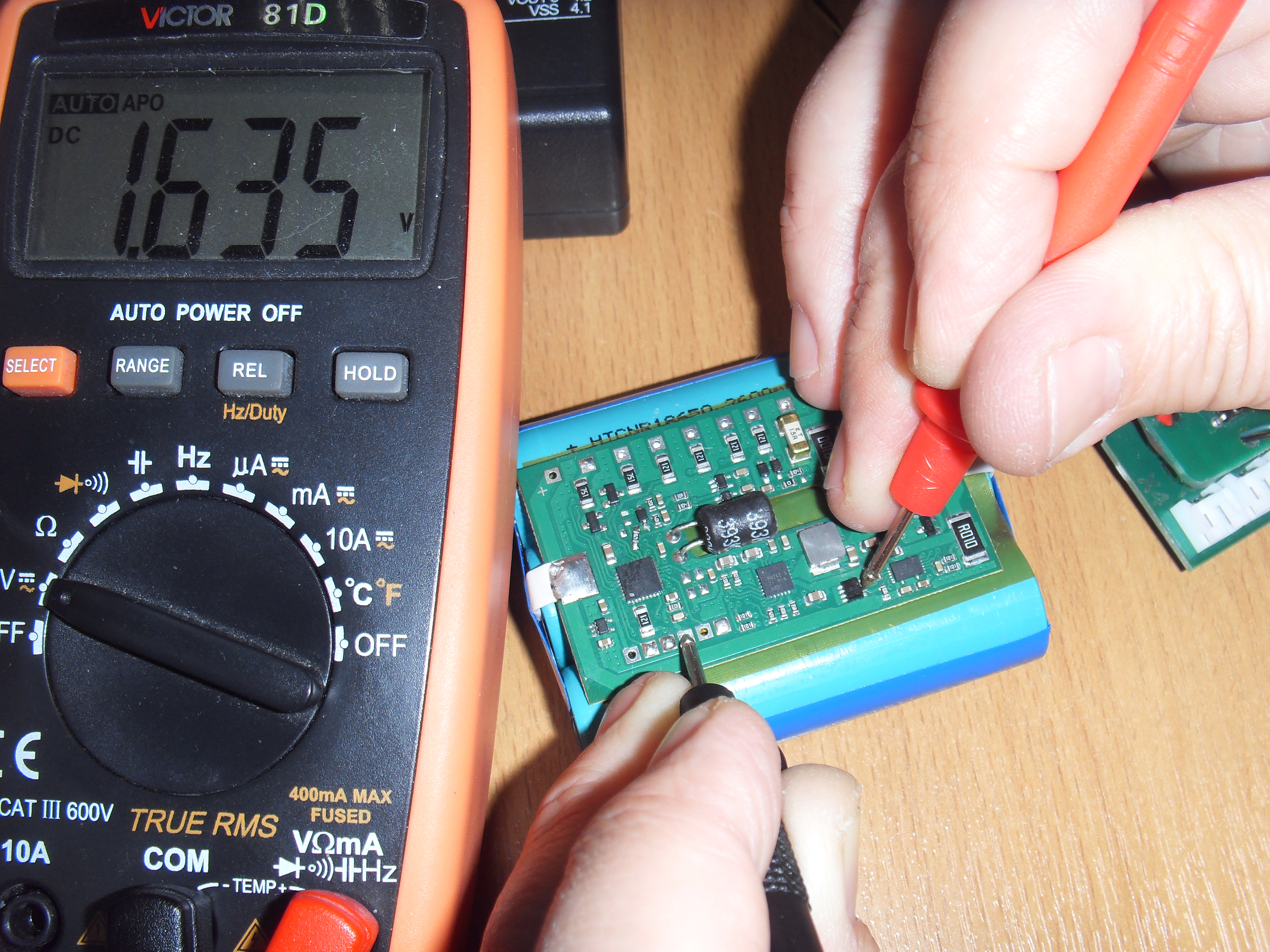

    Why voltage at Gate pins is around 2-3 volts? When FETs is off- this value is ZERO, when is on - around 12V. Why sometimes is 3v?
  • Hello Spider,
    Can you provide a scope shot and also where you are measuring?
    Gate pins should be zero with respect from the gate to source (in this case pack+), can you measure that voltage? I believe if the protection FETs are off, that voltage should be zero.

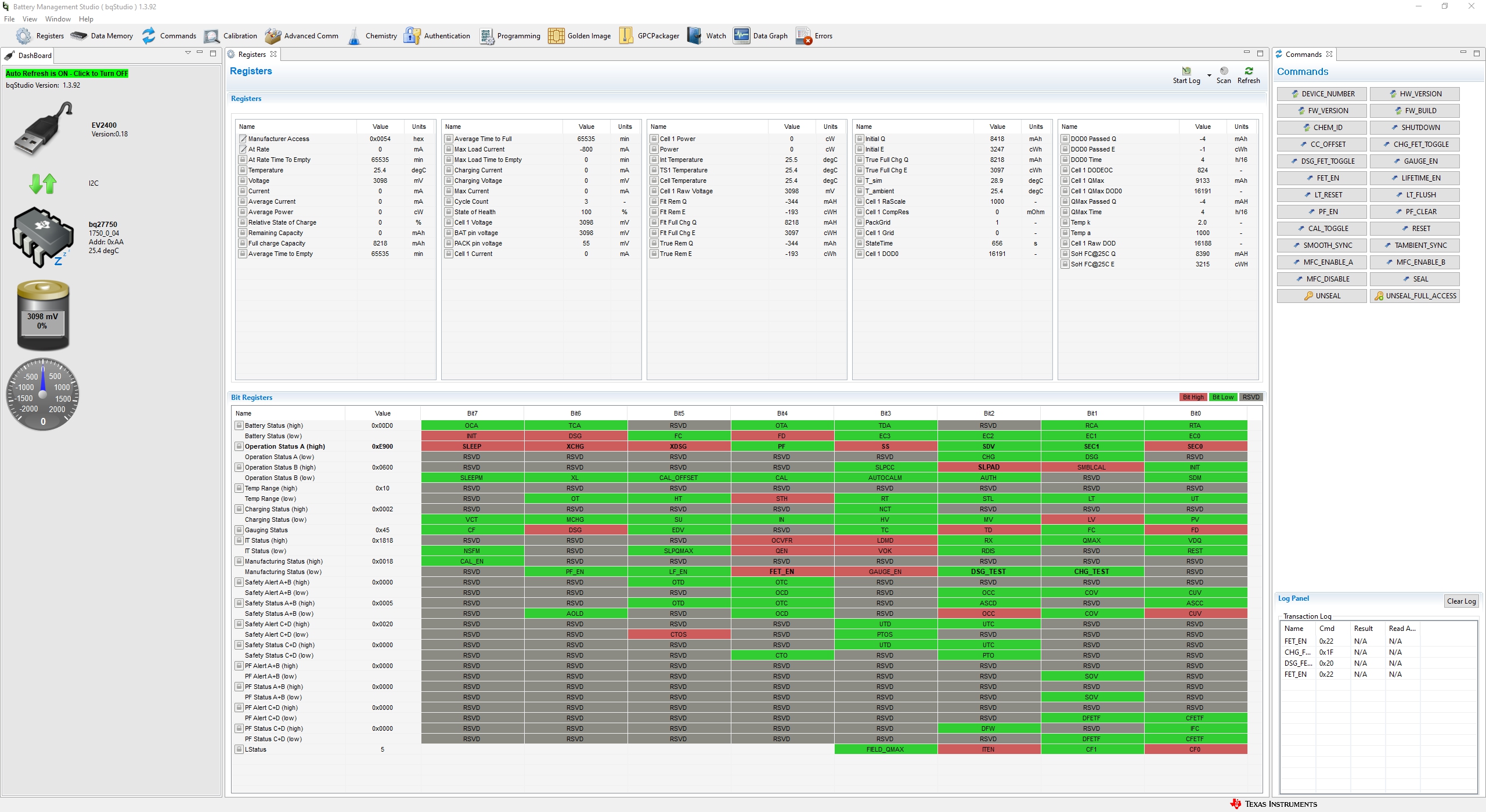

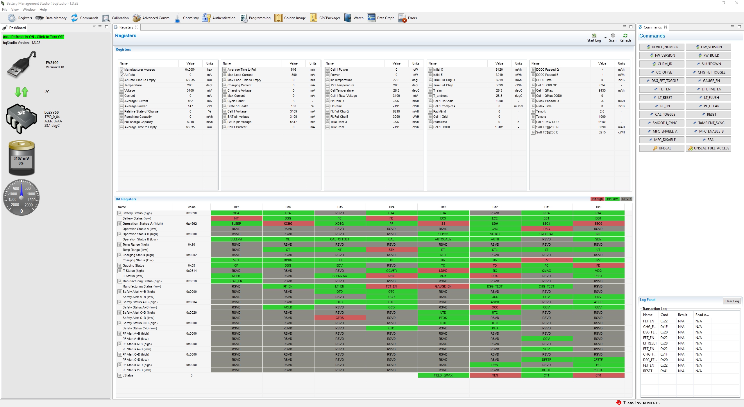

  • Before Reset but with Closed FETs:
    After reset and with Opened FETs (see to Log panel):

  • Spider,
    In the above bqStudio image you have CUV tripeed which would cause the discharge FET to turn off. in the 2nd plot it is not set, I believe you are tripping the protection which is killing the FETS.

  • Where you see that protection is activated? I see that Charge FET is ON on first screenshot of bqStudio. But really FET is OFF.
  • Can you mark where I can see that protection is activated?
  • Spider,
    There are registers called "Safety Status" and "PF Status" which give flags to indicate when event occured. In your plot you have OCC (over current in charge) and CUV (cell under voltage)
    Eric Vos
