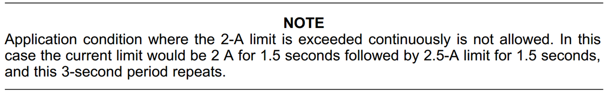

It’s found that fault will not be triggered when SW pin exceeds max current. Since application condition where the 2A limit is exceeded continuously is not allowed, does tps61193 has any mechanism to protect against this case?

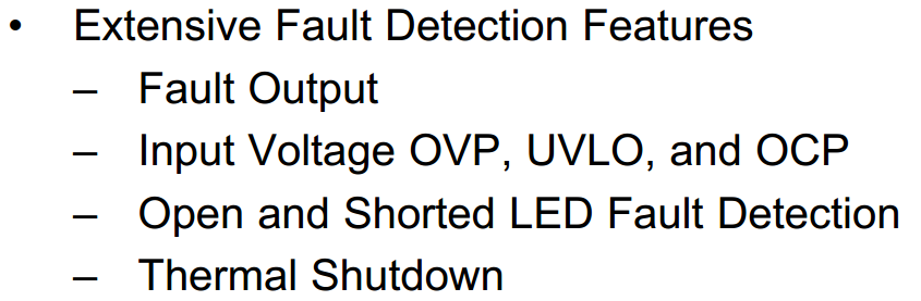

BTW, how to understand OCP described in “extensive fault detection feature”?

    • BTW, how to understand OCP described in “extensive fault detection feature”?
            When the transient SW DC current  exceeds 2A, it will lasts for 1.5s and then the current limit is automatically increased to 2.5 A for a short period of 1.5s. And then this total 3s periods repeats until thermal shutdown.
    • To ensure the SW DC current exceeds 2A, please also provide your load current and the value of inductor when the input voltage is decreased slowly to 2.5V. I suggest that you measure the current actually.
    • Please also note that the table 3, the SW DC current OCP is not included in the fault detection.
    • However, if the SW DC current OCP happens, the behavior of chip is described in my first reply to your question. You can check this by measure the inductor current through current probe.
    Hope this helps.
