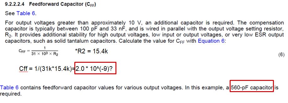

LM2596: feedforward capacitor selection
Part Number: LM2596
Hello team!
I got the question for "cff" from the customer. The datasheet shows Equation6 and uses the 15.4k for R2 for example.
However, the calculated value and the recommended value look different...
Which value should we use for the actual design?
