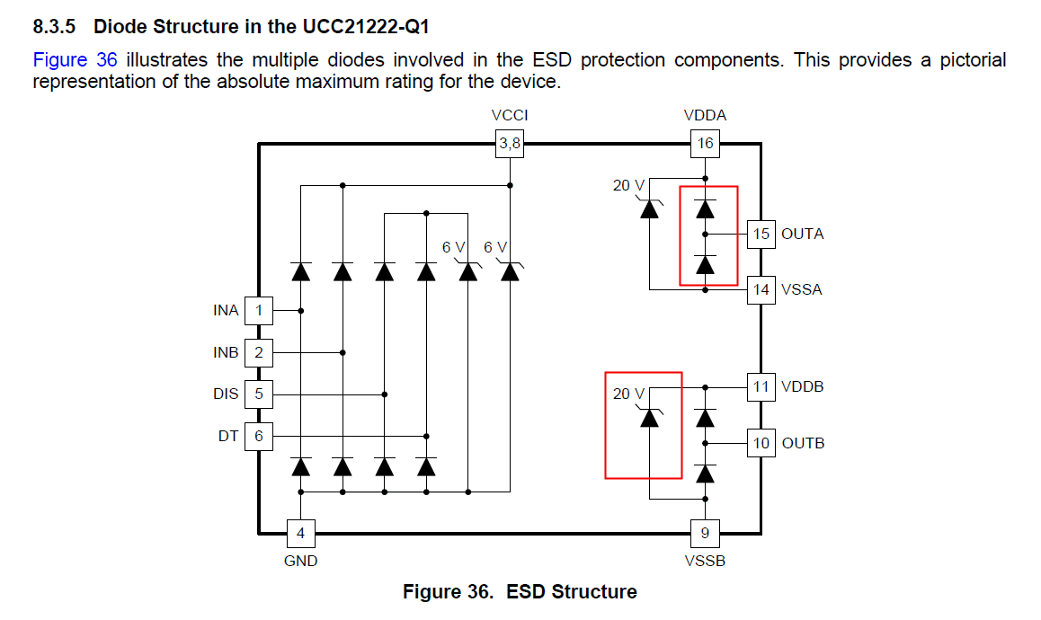

Can you let me know what is the 20V TVS power level of UCC21222-Q1? Thanks.

    Can you please give me more details behind this question? This device passed ESD qualification with:
    Device HBM ESD Classification Level H2 - +/- 4kV
    Device CDM ESD Classification Level C6 - +/-1.5kV
    If you are asking in terms of overshoot/undershoot, we have characterized the device to withstand down to -2V undershoot for 200ns in the system. Please reach out to me offline if you are not able to share more details.
