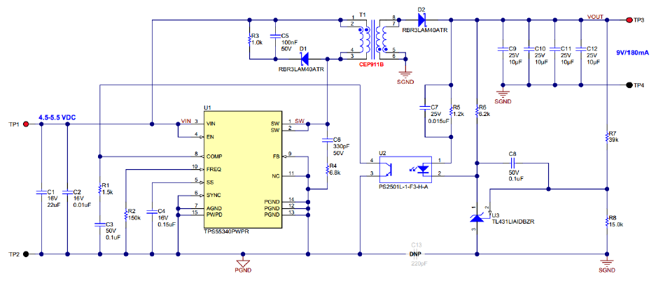

Could you please advise us how to calculate power dissipation of TPS55340 on the following Flyback configuration?
My customer wants to know power for calculating Tj.
Input : 5V
Output : 9V @ 180mA

Hi M.HATTORI.,
Please find the calculation in slva559.
Please let me know if you need other information.
