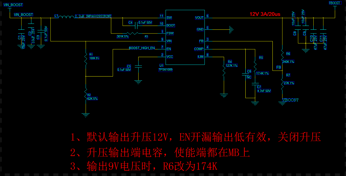

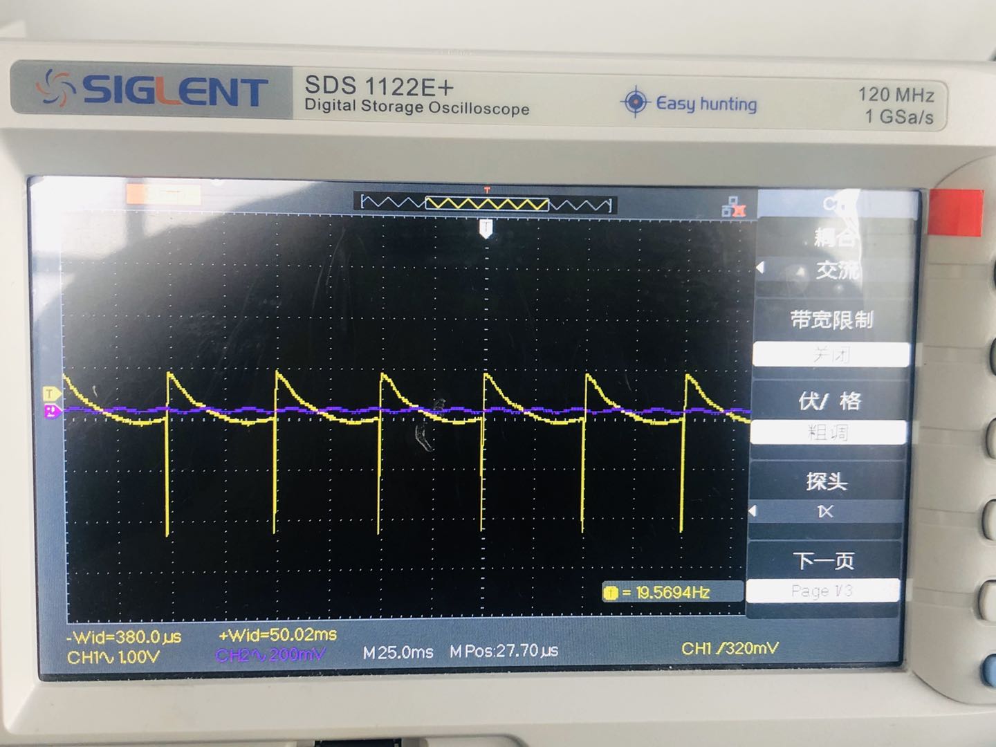

Hi TI team ,
        My customer used TPS61089 which comp circuit is the same as Typical Application in specfication. But they found the load transmit are not both quickly and good(Test conditons:0A@ 0.5ms ->2A @ 0.5ms)
And there is a huge voltage-drop like the following picture. we will appreciate if TI can give some advice to improve performance of load transient.Thank you!
