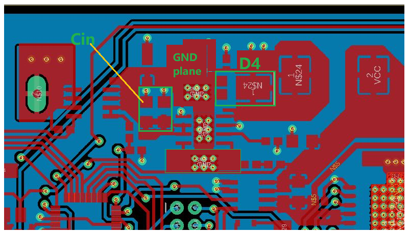

So I am thinking maybe I need to go to a higher power part, but just want to check if there is anything I can do otherwise. I have a design that takes in 20V from a battery and drops it down to 12V to a 3.5A blower fan.
So the part is getting very hot and I was thinking I wasn't that close to the 5A max, but maybe because of the voltages I am using it dissipates too much power. I also only have a 2 layer board and didn't realize they were assuming you use 4 layers.
Layout.
    The PCB layout design is not optimized for thermal, even a 5A regulator will also be very hot with this design:
    Pls arrange it as below if you want to re-design it:
  • Thank you i make those changes on my next prototype and I was looking at maybe adding a heat sink to the back side for good measure.

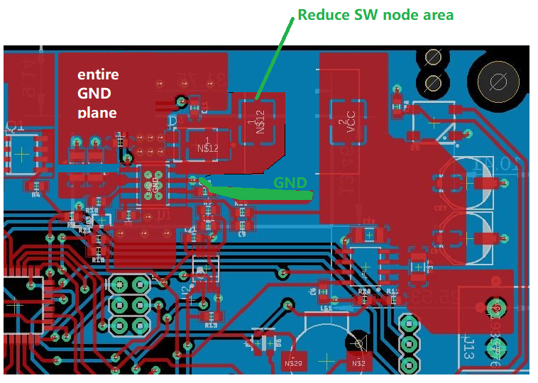

  • So I made the changes and just put together a new board today and it is behaving weirdly. So the output goes to a 12V brush less blower and the blower starts to spin up and maybe just a bit before it gets to full speed it and all of a sudden the output voltage drops to about 5V. Any clue what would cause that? The previous one didn't do that. I did change the feed back resistors to 150K and 10K instead because that is what your web tool used. I also had a programmable resistor IC on lower feedback resistor, but I have a way to bypass it and doing that didn't make a difference.
    First please check your circuit with Electric load or resistor load to see what's maximum constant load current it can drive stably, then check it with transient load like 0.5A to 5A at 1A/us to see if loop regulation is stable.
    Then, drive 12V BLDC blower with 12V DC power supply, check the startup current waveform to see the peak and duration.
    If the peak is below 5A~6A, then it  can be driven by converter board directly, otherwise you may need to increase cap of 12V output.

    Because of high thermal resistance of your PCB layout, LMR14050 RDS(on) becomes higher on your application, the current rating of inductor maybe also different from Webench design, these items will reduce conversion efficiency, so the total input power maybe higher than Webench result.

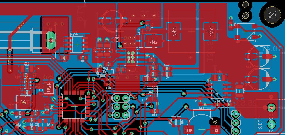

  • I keep forgetting to get back to you on this. I wanted to show you the updated layout. So do you think there is still issues with it? I'm just curious what I could do better int he future. For now I put a heat sink on the back of the board.
    Please modify it as below:
