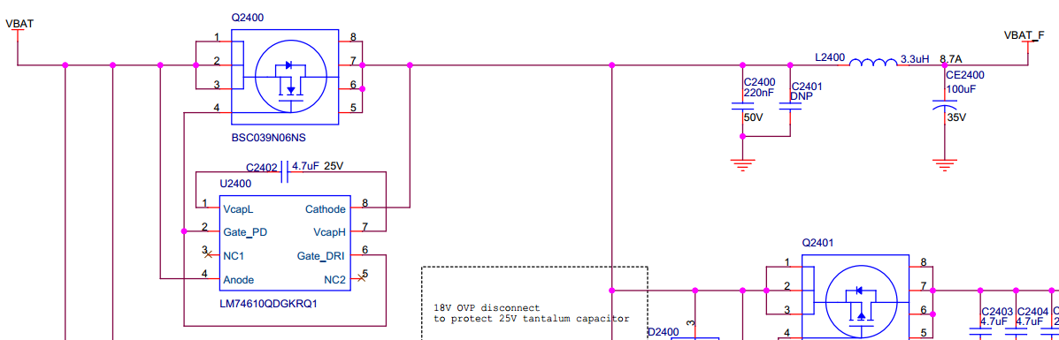

Dear expert:
I’m using 4.7uF Vcap according to reference design.
When my probe is placed at net VBAT_F, T0/T1 are 33ms/2464ms, respectively. However, according to formula1 of spec page10, T0/T1 should be 100ms/5.7s, respectively. Why my result is so different from spec calculated?
BTW, When my probe is placed at net VBAT_F, and another probe is also placed at LM74610 pin 7 (VCAPH), T0/T1 are 33ms/830ms, respectively. It seems that VCAP discharge time is largely reduced due to probe. Can you share me some precious suggestio ns please?
