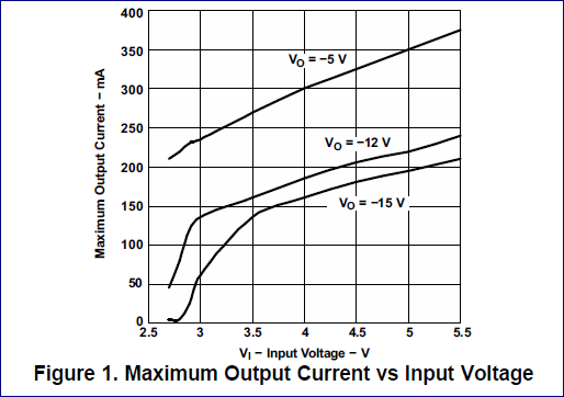

Would you advise my customer's question of Vneg max current at
Vin = 3.15V, Vout = - 6.7V?
Because max current  is difficult to estimate from the below graph in datasheet.
Best regards
Shidara
  • Hi Shidara,
    Looking at the graph, I would say at least 200 mA.
    We can also measure it in the lab, but due to the limited lab access this might take a few days, and the results would anyway have at least 10% uncertainty due to device tolerances.
    Milos
  • Hi Shidara,
    We have measured the maximum output current to be around 215 mA on the EVM. You can also use Equations 3 and 4 from the datasheet to estimate the maximum output current. The equations give around 210 mA for your conditions. Please note that this is not a precise value, and you should expect at least 20% variation.
    Milos
  • Hi Milos-san
    Thank you for your advise. I understood.
    My customer have to find IC that meets more than 200mA available IC with the same condition.
    I think TPS65131 is the candidate, do you know other recommendation?
    Shidara
  • Hi Shidara,
    It looks like the TPS65131 could fit. This is a split rail converter, do you need only negative output?
    Some alternatives are:
    1. LM2611 can support up to around Iout = 350 mA for your conditions.
    2. PTN04050A is an inverting module, however it is not a low cost or a small device.
    3. Buck converter in inverting configuration, as explained here:
      http://www.ti.com/lit/an/slva542a/slva542a.pdf?ts=1588350907715
      If this is fine, I will ask buck converter experts to help you with selecting the right device.
    Milos
