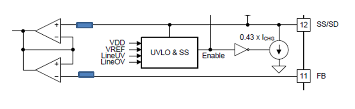

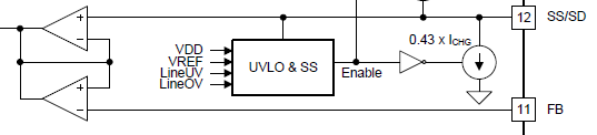

Hi team,
As the datasheet shown, the amplifier output will be the lower voltage of VFB and Vss. How to understand the this amplifier configuration work principle?
Hi team,
Hi Dylan,
The simplified block schematic is intended to show that the output of the opamps is which ever is the lower value of FB or SS/SD pins.
I added the resistors (marked in blue) to the block schematic and this is intended to show that the negative input of the top opamp and
the positive input of the lower opamp will force the corresponding input to equal the output.
Hopefully this gives helps. Remember this is only a visual block schematic of the actual ic design
John
