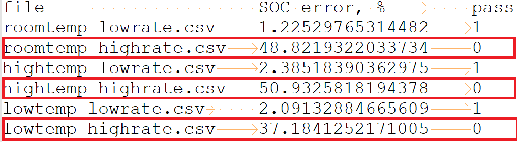

Hello
My intend is to use bq34110 to do the gas gauge of a 10S NiMH battery. To have the CEDV parameters, I made characterization of my battery and record time, voltage, temperature and current with data logger. Then I put these data in a GPCpackager (File VHTF_10S_GPCPackager attached below) as you request on your web site. Then you send back Gauging Parameter Calculator report but in this report you wrote: "The following errors were reported by the calculation engine: Accuracy Error: Deviation is so high that it is most likely due to anomaly in the data. Please check that data files have recommended format, units and test schedule". I checked the data files and as I didn't find what is wrong, I ask for your help.
