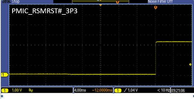

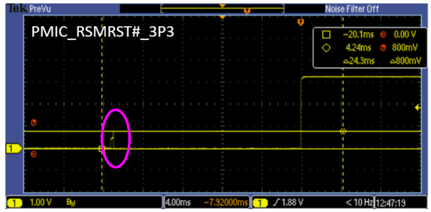

      My customer recently encountered a problem with the RSMRSTB output.
      During startup, there will be a glitch at the RSMRSTB output of TPS650942.

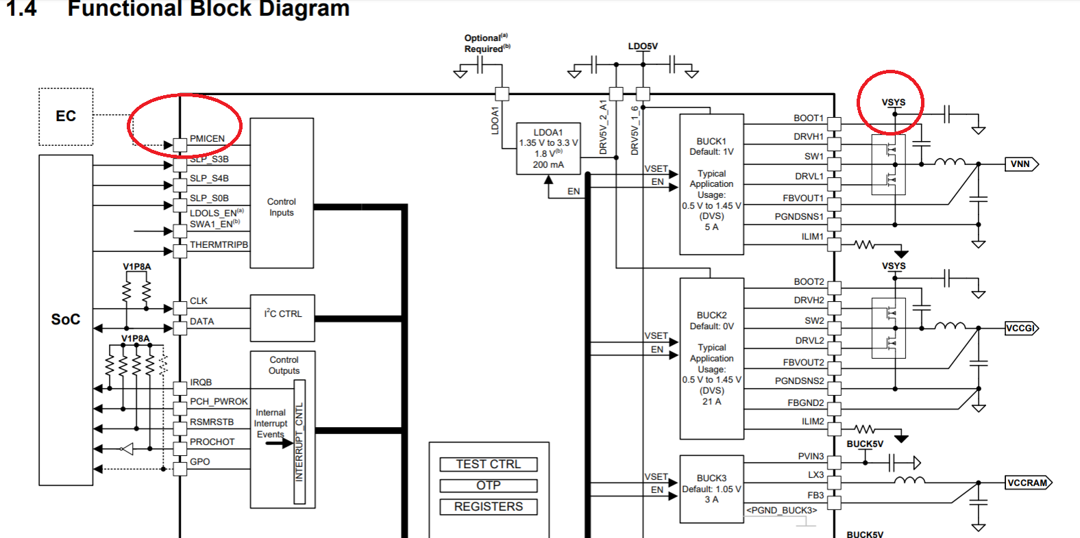

  They found that it is related to the delay between the supply volage (VSYS) and the enable (PMICEN).
  If the PMICEN is asserted high right after the rising of VSYS, the glitch occurs.
  If adding a delay after the rising of VSYS, the glitch disappears.
  Are there specific timeing requirements beween the supply voltage and the PMICEN?

    When is power applied to V5ANA? There is strict timing requirement between V5ANA and VSYS, but I cannot see in your scope shots when any of the input signals are applied.
    Please share scope shot using all 4 channels:
    1. RSMRSTB
    2. VSYS
    3. PMICEN
    4. V5ANA
    And then I can provide feedback on what might be causing your issue.
