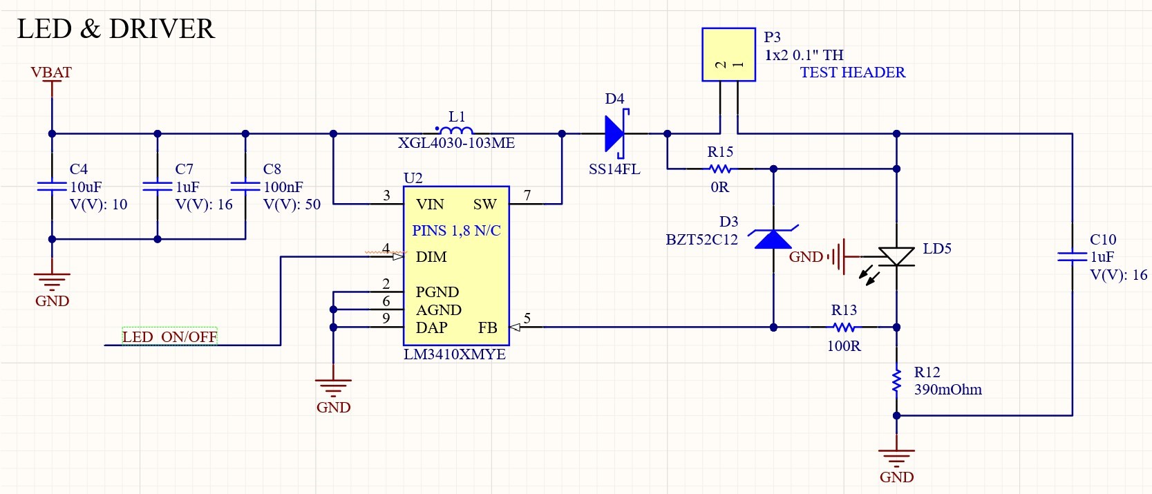

I am having issues getting this circuit to behave as expected.  I have checked for shorts between each of the pins, and that seems OK.  Vin = 3V with Vf(min) = 5V for the LED.  For now, the protection circuit has been removed (R13 = 0R, D3 is removed).
I notice that Vled measures as 5V (so it is boosting) but the current draw isn't right.  With Rfb=390mOhm I would expect that Iled=500mA.  But I'm seeing a total current draw of 120mA, including all the other circuitry on the board.  So something isn't working right.  And I measure about 15mV at pin 5 (FB).  I believe that should be around 200mV.  How could that be lower?
P3 is a 2-pin jumper, right now shorted out.  Eventually, I'll use that to verify the LED current.
Here is a screenshot of the schematic:

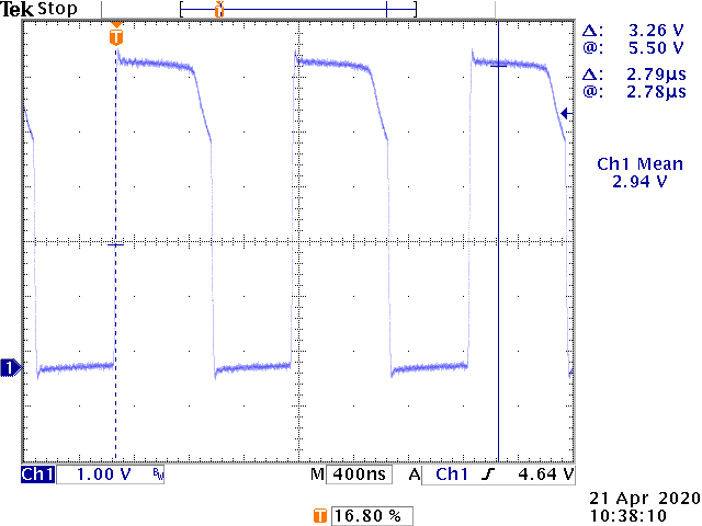

Below is a scope shot of the inductor voltage (pin 7):
Any pointers on where to look to figure out why the current isn't right?

    And R15 is NOT installed...
    Are you measuring fb from the IC GND to pin 5?  Have you looked at the input voltage to make sure it is not drooping?
    The switching frequency is below 800 KHz, something isn't right there either.  Does you layout have a solid ground plane?
    What is the ground connection on the LED?  If that is the heatsink pad check to see if it is isolated.
    I don't see anything wrong schematic wise.

  • Hello James,
    On the LED there is a ground connection per the schematic.  The anode and cathode are not tied to ground that's what I was asking, is the GND connection isolated from the other two connections?
    You can try increasing the input voltage to 4V or so just to see if it behaves different.  Are you measuring the voltage at the input of the LM3410?  How is the supply connected to the board?

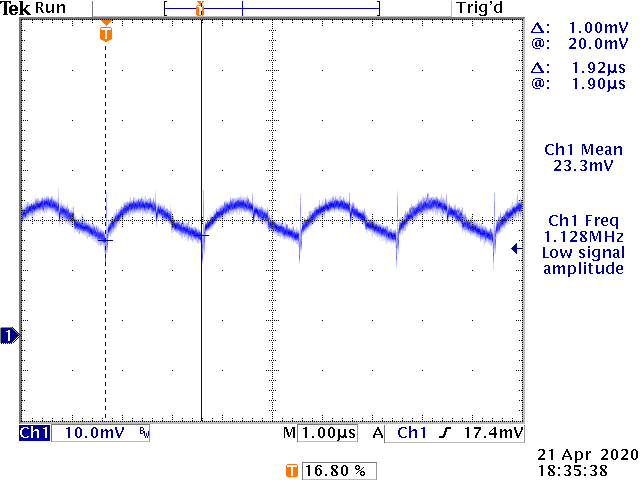

    I've measured the FB with both oscilloscope and multi-meter.  Both give values around the same value.
    And I've confirmed that I have the part I think I do soldered on. The markings are SSXB which, according to the datasheet, is the LM3410XMY that I intend.
    Attached is a scope shot of the FB node, with very short ground loop so as to not induce extra ringing.  This is with DC coupling, so you can see the average is about 23mV, but there is a very definite noise pattern:
    Strange indeed.
  • I should mention, that this last scope shot was with a 6.8uH inductor that is rated up to 3.9A (XAL4030).  It has a higher current rating then then 10uH I was using and I think that's a better value anyways.  But I still can't get more than about 100mA out of it and the FB voltage is messed up.

    The last waveform doesn't make sense from both the frequency and also the wave shape, it should be current ramping up and down, triangular (though that can be from the output capacitor).
    One thing you can try is to increase the current sense resistor value up to regulate a much lower current to see if it starts to regulate and switch at the correct frequency.
