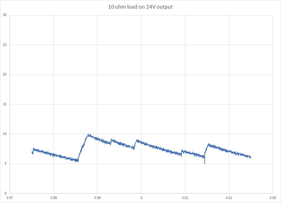

UCC28630: When using the UCC28630 in a 24VDC supply, increasing the output load shuts the output down.
Part Number: UCC28630

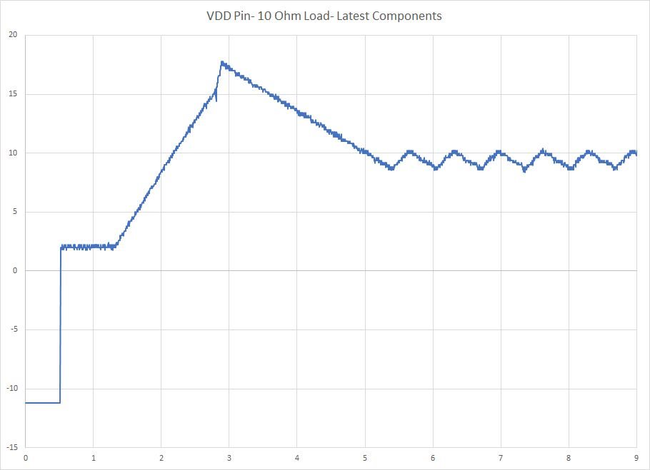

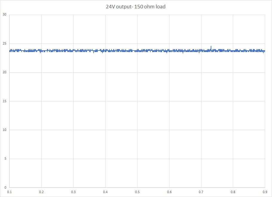

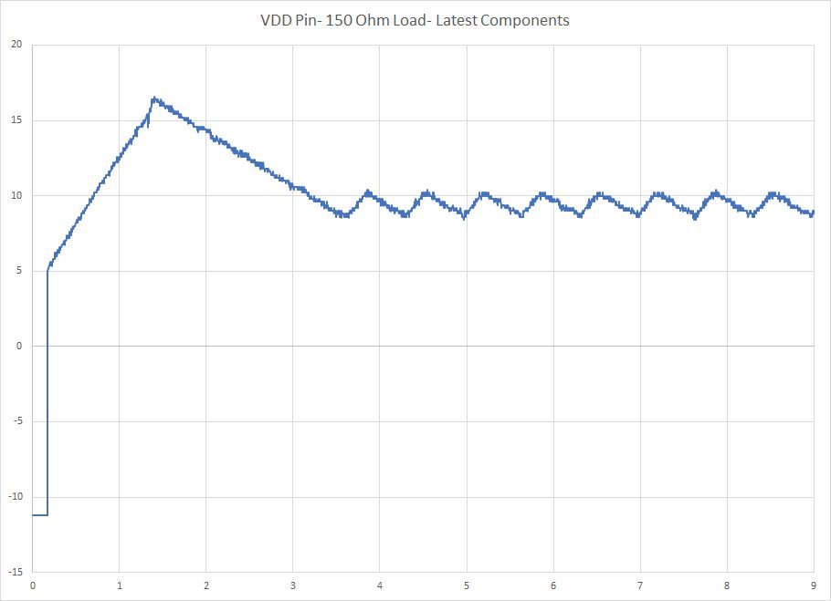

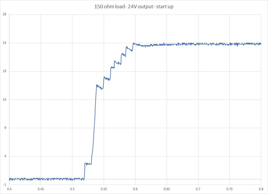

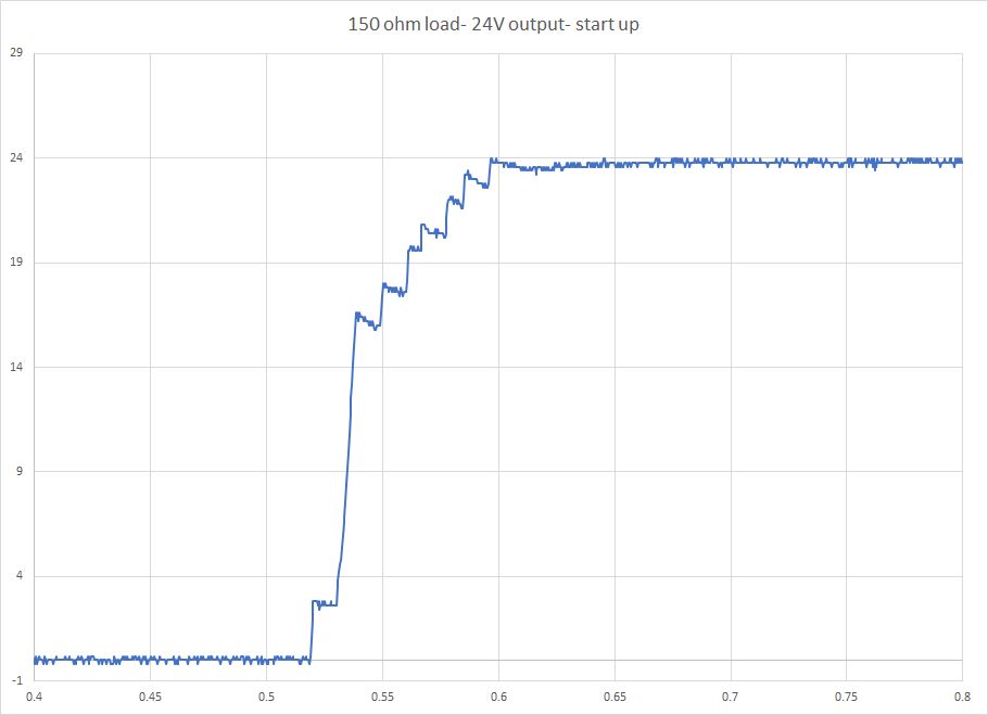

150 ohm load start up
150 ohm load running
10 ohm load- output
I changed the mosfet sense resistor from .12 ohm, to .10 ohm. Now output just jumps up then down.

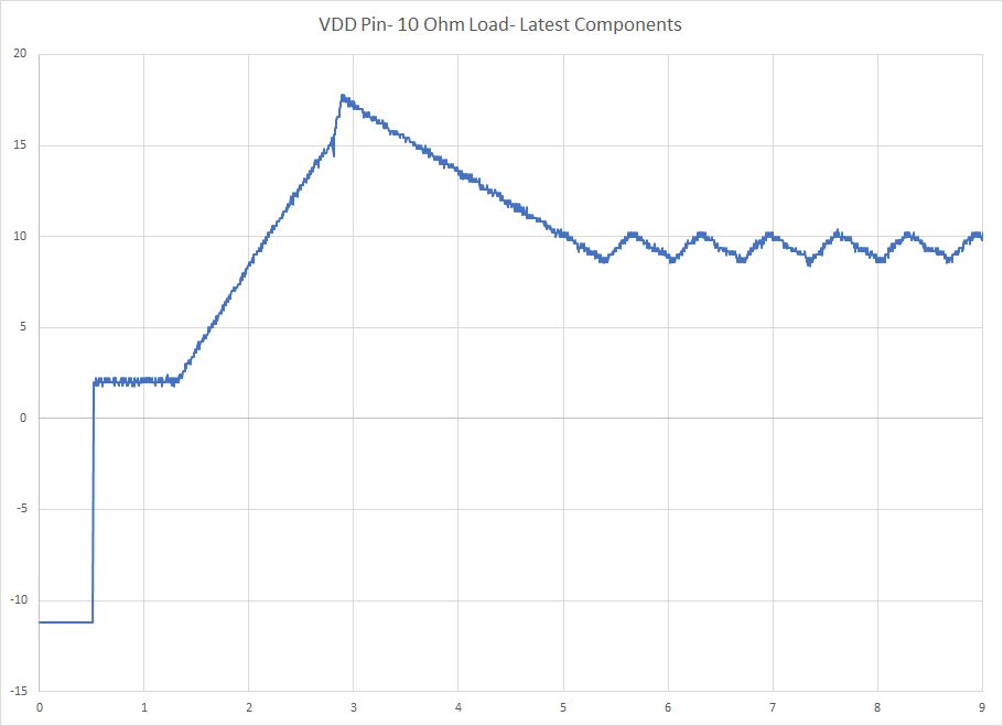

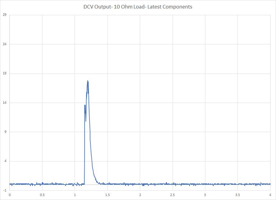

    Table 3. (page 42) of the UCC28630 datasheet has a list of all fault conditions that UCC28630 measures for.  If any of them are triggered, UCC28630 will stop operation.  Depending on the fault, it will either be a latch fault response (where VDD needs to be removed, which is done by removing the AC input) or auto restart (where once VDD discharges to VDD(reset) (5V typ) before attempting to start up again.
    When you start up into a 10Ω load, one of these faults may be triggering.  I recommend that you measure the key pins during this undesired startup operation to see which one is triggering the fault.  Once you identify which fault is being triggered, you can adjust the components that connect to the pin to prevent it from triggering fault shutdown.

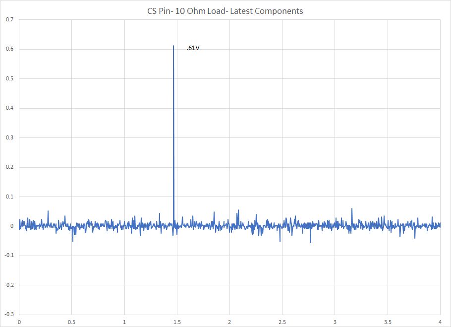

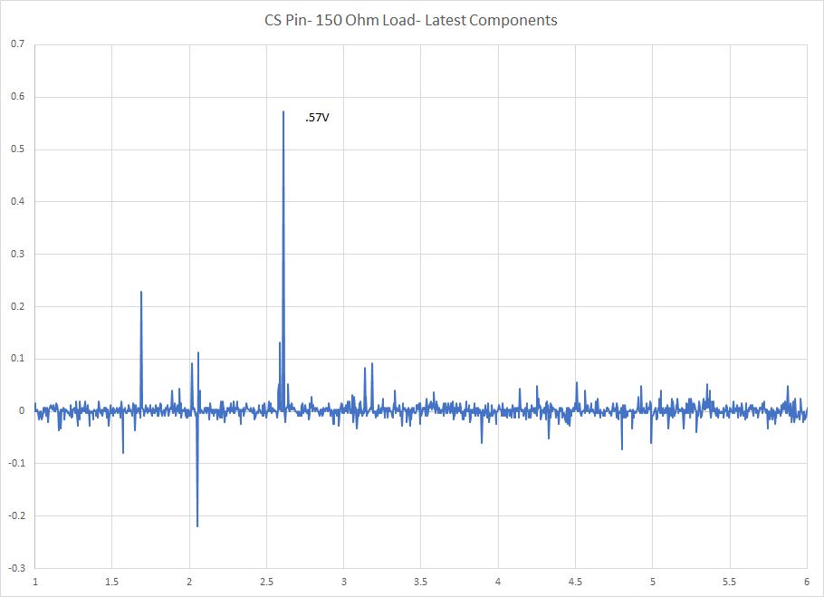

  • We have changed components from the original design :
    R24= .10 ohm
    C3/C4= 220 uf (one cap)
    22K DRV pull down
    R18= 28K
    R30= 32.4K
    R29= 2.2M

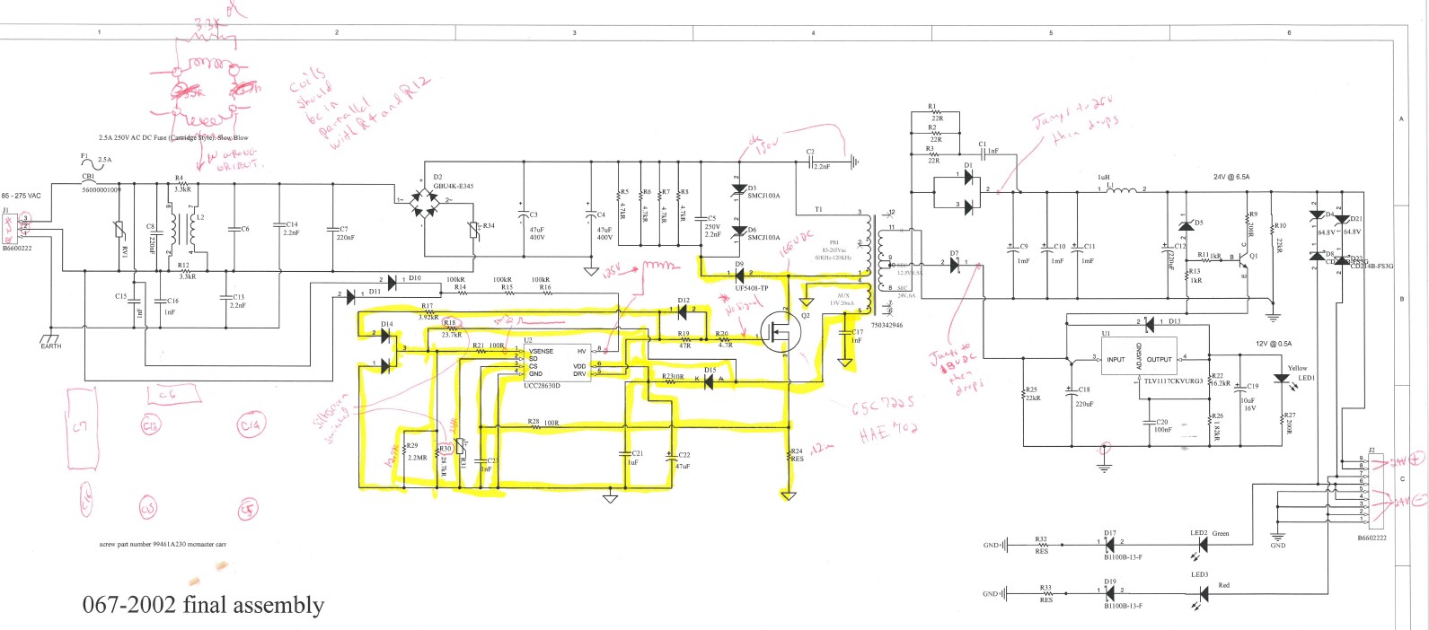

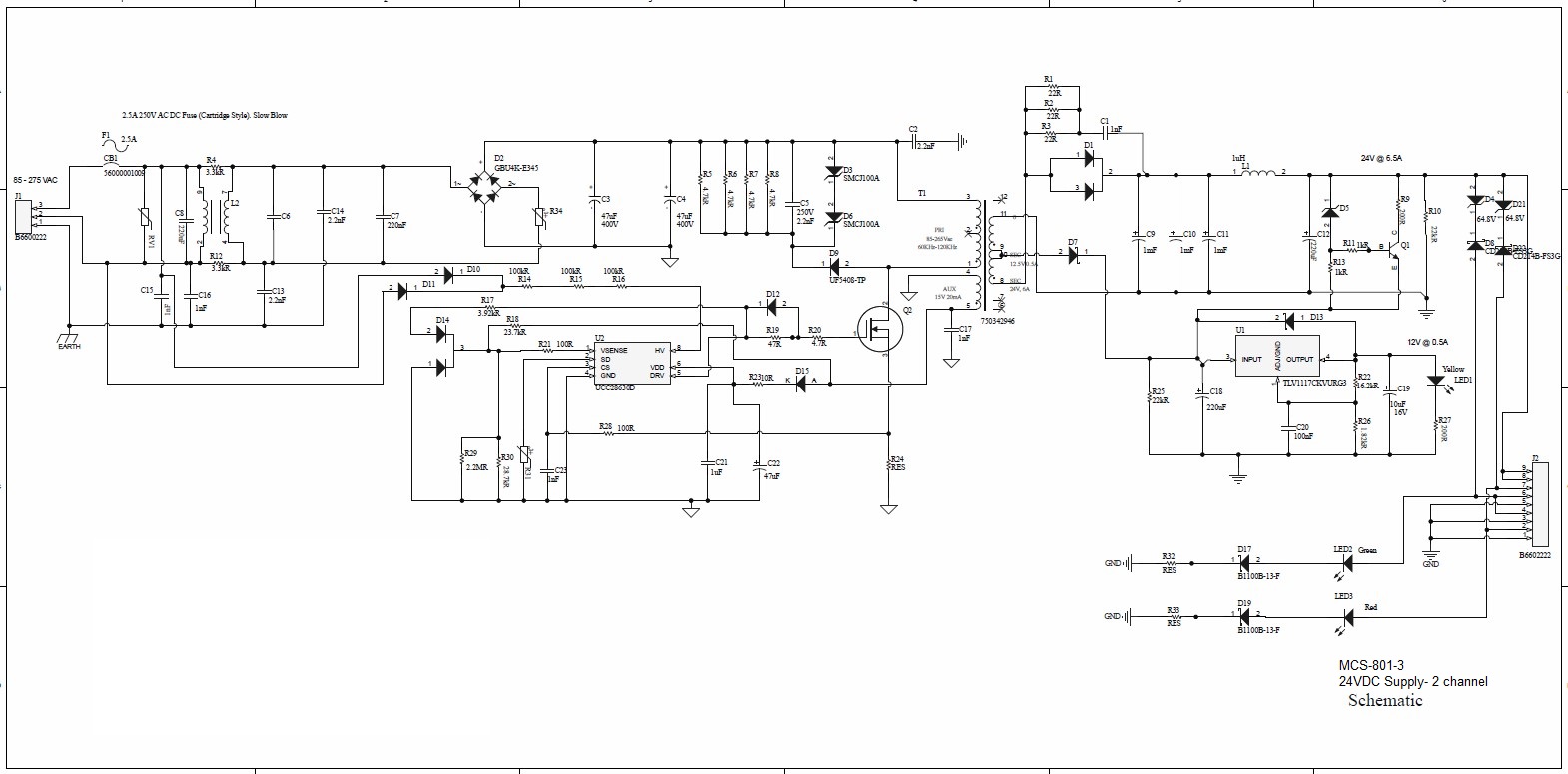

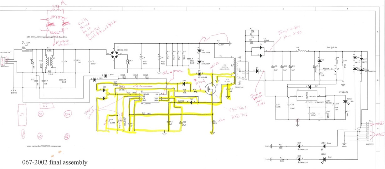

    Here is the original design schematic:

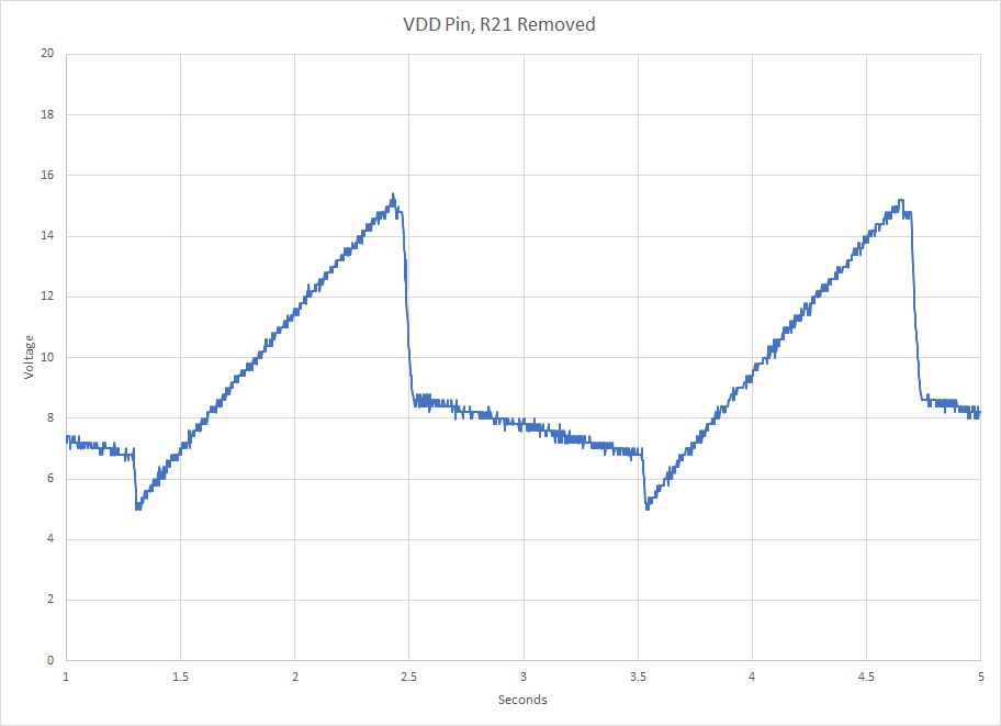

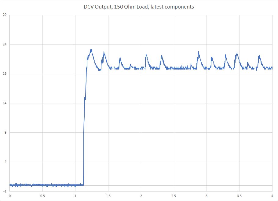

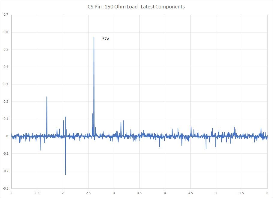

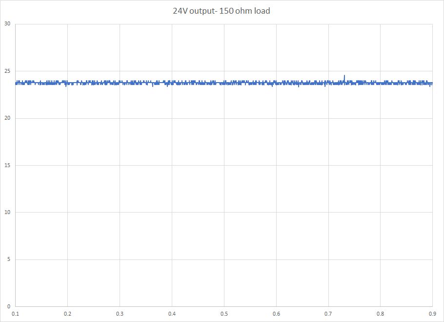

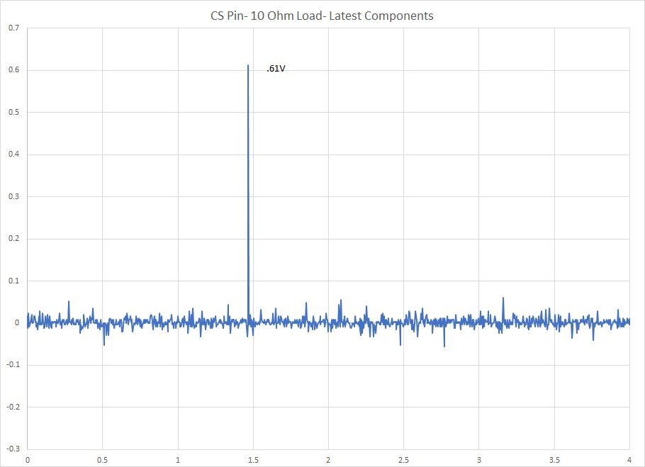

    I then did plots of the DC Output, VDD, and CS pins at 150 ohm and 10 ohm load.
    See the plots below:
    Then removed R21:

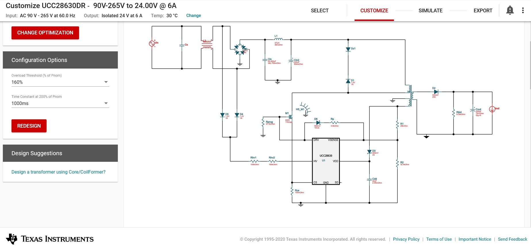

    How did you determine these new component values?  If you did not, we recommend you use our excel design calculator http://www.ti.com/lit/zip/sluc537 to calculate what the component values should be.
    If you have any concerns about using the excel design calculator, we recommend that you use our webench calculator (on the right side of this page http://www.ti.com/product/UCC28630) to determine what the recommended external component values are.  We recommend that you verify all the components you use match the recommendation.
    Eric
  • These values are from the Web Bench simulator, 24VDC @ 6A entered in.
  • I noticed there was a BOM along with the web design schematic, attached.
    A couple differences I saw between the 801-3 design (top line) and the web design (bottom line)- below, were:
    C12= 1) 220uf
    Cout= 9) 220uf [2000uf]
    D14= BAV70 Fast Switching
    D6= Schottky 70V- 15ma
    D15= MURS120 Superfast Recovery 200V- 1A
    D3= Schottky 200V- 2A
    D10/D11= CGRM4007 General Purpose 100V-1A
    D4/D5= Ultrafast 800V-1A
    C21/C22= 1uf/47uf
    Cdd= 22uf
    D3/D6= SMCJ100A 100v + 100v= 200v
    Dz1= 150v

    I don't understand what your question is.  Our recommendation is to follow the design values that you generated from the webench design.  I do not understand where the design that you are comparing it has come from, so I cannot comment about any of those component values.  If you see a discrepancy between that design and the webench model, we recommend you modify the design to match the webench model value.

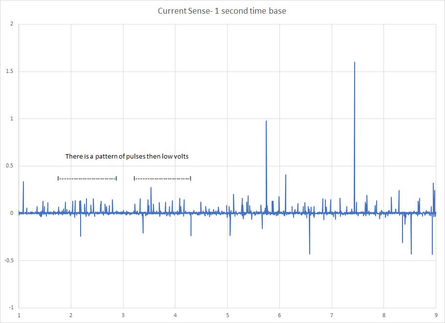

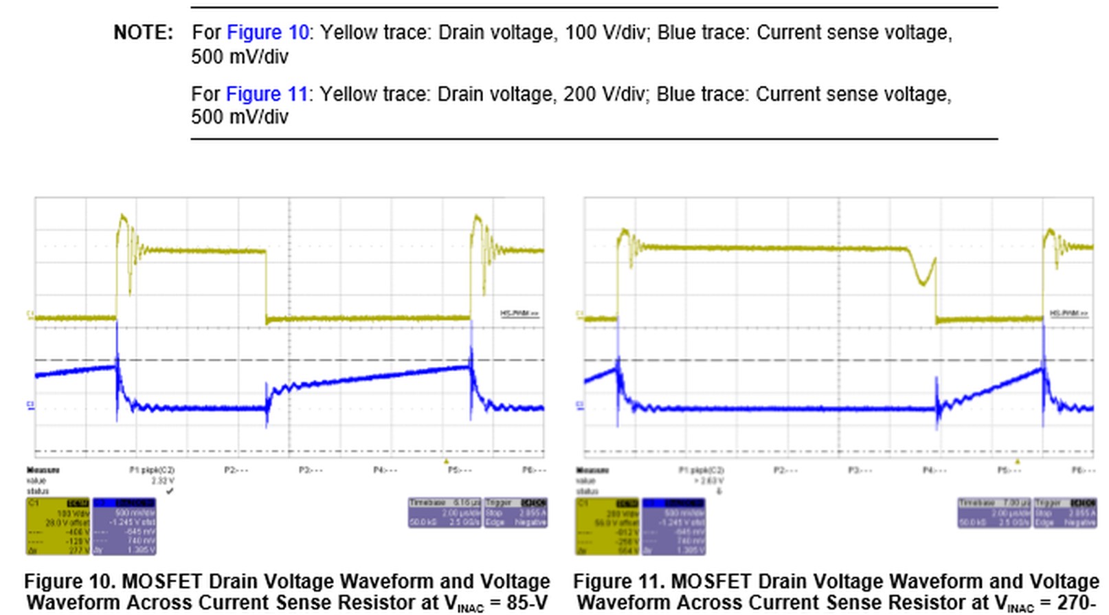

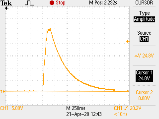

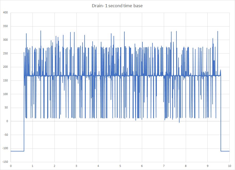

  • We are following the webench basic model, only with some additional low value current limiting resistors. Do you have any plots of what the different pins on the UCC28630 should look like? We are getting pulses like below:
    However we found this on the web, which doesn't match:
  • Tim
    Best place to see what expected waveforms for UCC28630 is the EVM http://www.ti.com/tool/UCC28630EVM-572.  The user guide for this EVM has typical waveforms http://www.ti.com/lit/ug/sluuax9b/sluuax9b.pdf?ts=1590872018331.  If it does not include a specific waveform you're looking for, you can order this EVM and measure the waveform yourself.
    Can you confirm the timescale of the waveforms you provided?  There is no label, but they look like they are too long.  I recommend that you use the same voltage and timescale of the waveforms in the apps section of the datasheet or the EVM http://www.ti.com/tool/UCC28630EVM-572.
    Eric
