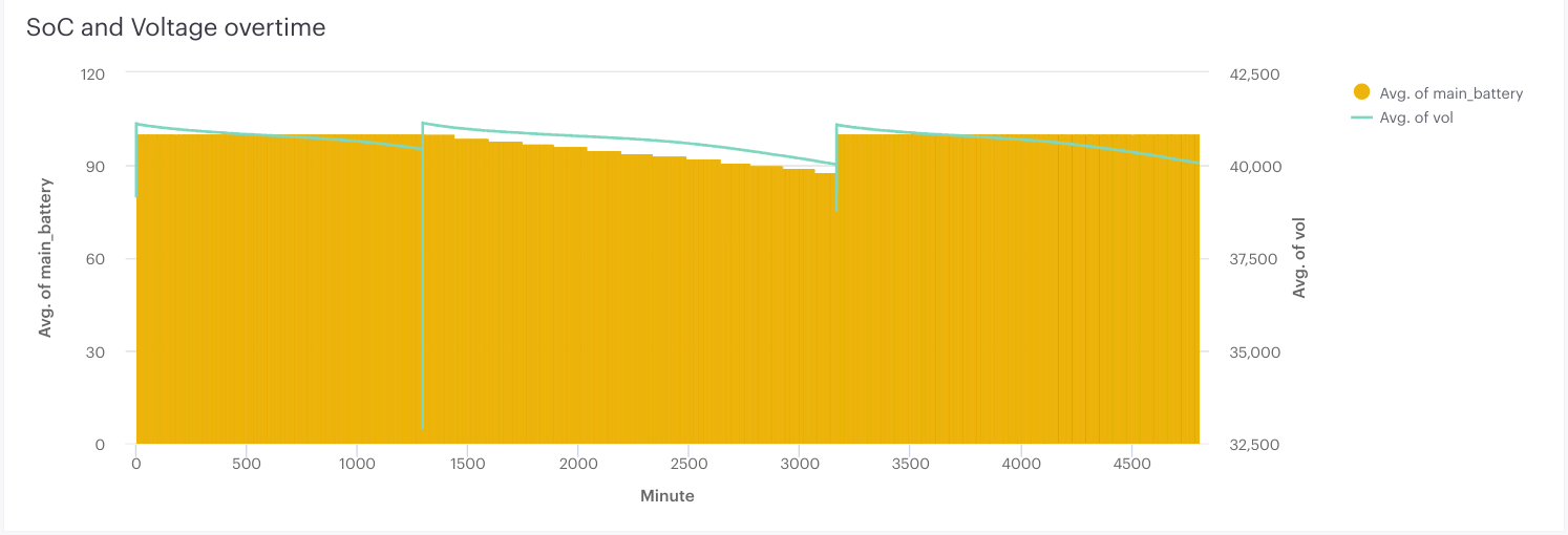

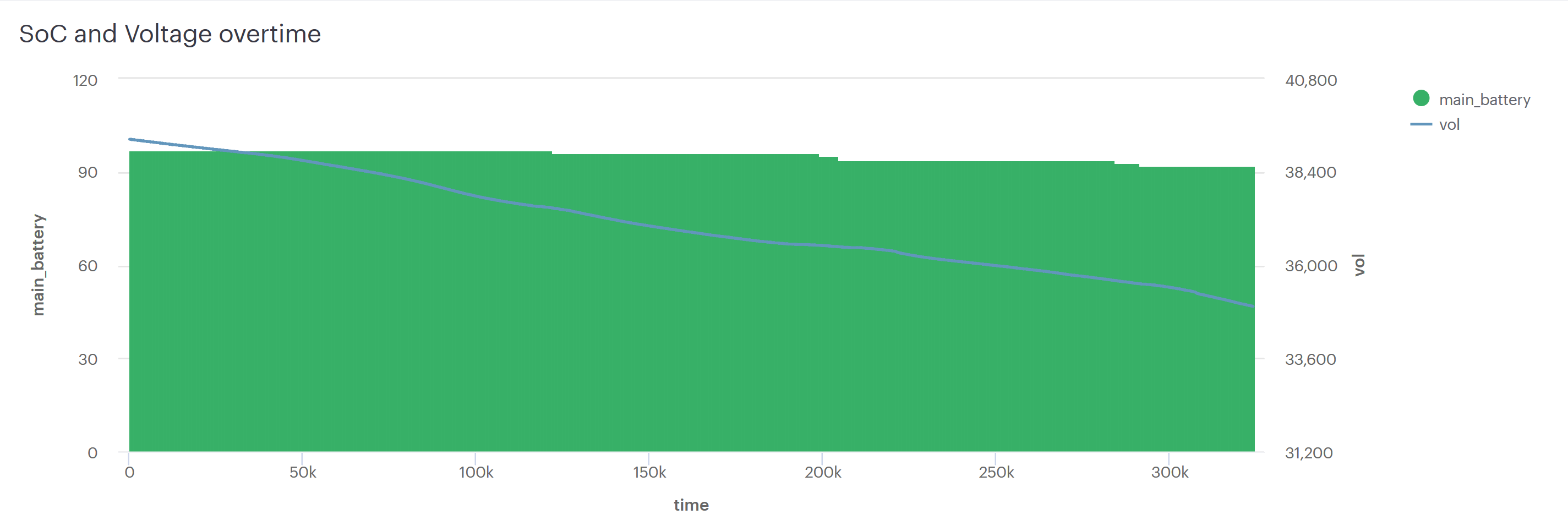

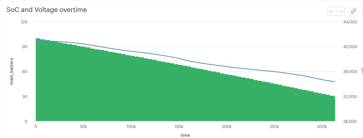

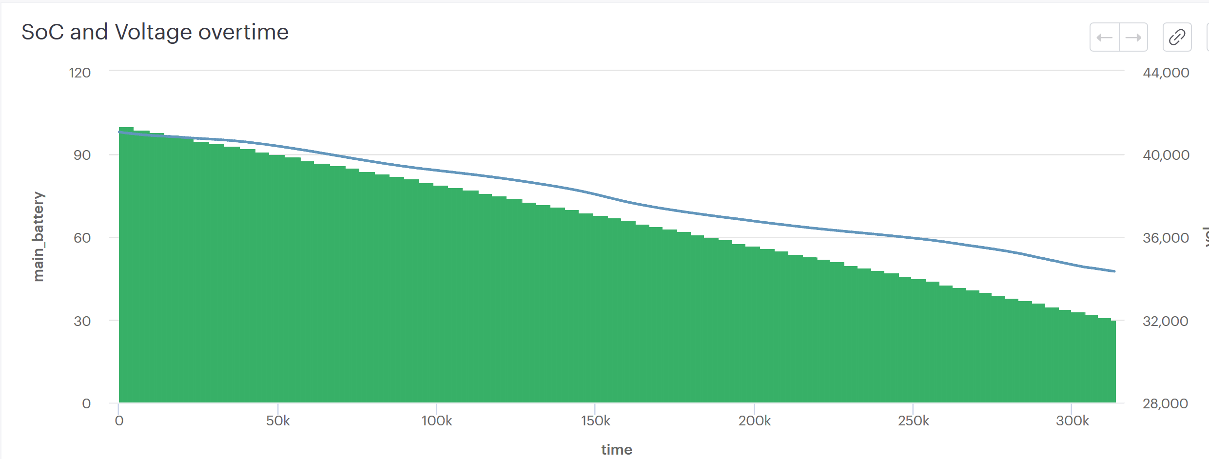

We have configured our BQ78350-R2 device to use IPSCALE: 1. However, when the current drops below ~60mA (we noticed this on a change from 100mA -> 60mA), our battery state of charge stays constant, even as battery voltage steadily declines with a near constant current draw. Do we need to scale the following setting as well?
Calibration | Current Deadband | 0x4319 | Coulomb Counter Deadband | U1 | 0 | 255 | 38 | 264 nV
To set the deadband to 8mA given a 1.25 mOhm resistor, should we set this to the Coulomb Counter Deadband to 4 because 4*10*264nanovolts/1.25milliohms = 8.4milliamps?
