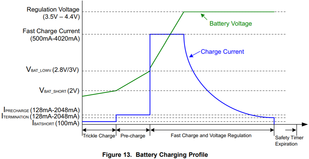

  • Hi Scott,
    Thanks for the information. I believe the simplest solution for your application is a charger from the BQ2419x family, such as the BQ24193. The charge profile is shown below.
    Here are some key BQ24193 parameters that are relevant to your application:
    • Maximum input operating voltage = 17 V
    • Max charge current = 4.544 A
    • Max precharge current = 2.048 A
    • VREG can be set as low as 3.5 V to accommodate LiFePO4 batteries.
    • The Default BAT_LOWV threshold is 3 V, but this can be changed to 2.8 V through I2C control. Therefore, the BQ24193 will apply the 2 A precharge current until your battery rises above 2.8 V, at which point the full fast-charge current will be applied.
    • The NVDC topology makes it easy to regulate the VSYS rail for your system load. With a traditional topology charger, VSYS can go as high as your adapter voltage (12 V), so you would need a separate buck converter to step VSYS below 5 V.
