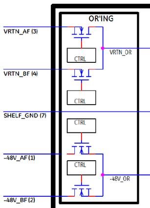

Can the LM74700-Q1 drive FETs in a -48V configuration. The customer wants to replace the GE PIM400. See blockdiagram below:

LM74700 is not suitable for negative ORing, but LM5051 is negative ORing controller.
But if you wish to use LM74700-Q1 on the GND side with -48V common bus then it can work.
Could you share more light on this one?
