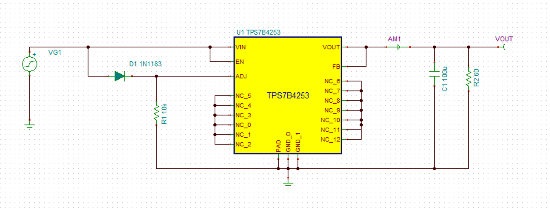

  • Hi Yi,
    Something like a tracking LDO seems like what you are looking for. The TPS7B4254 regulates to the applied reference. Here is a quick schematic and simulation:
    I will have to check with design to see if the NR pin of the TPS7A47 can be over-ridden to turn it into a tracking LDO.

  • Hi Yi,
    I confirmed with our design team that the device will operate if you drive the reference externally as described above. We have not tested this configuration so not sure at all as to how well it will perform.
    Do you have an EVM that you can try?
