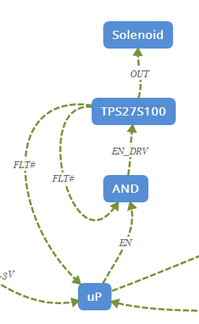

I would like to quicken the short circuit response time of my TPS27S100 based circuit and am considering placing an AND gate at the enable pin.  The inputs to the AND gate would be the FLT# and an enable driven by a microprocessor.  I assume this would create some type of oscillation due to the time delays of circuit but I am hopeful it will keep my current spike amplitude lower.  The microprocessor will eventually respond to the FLT# and deassert the enable.  See embedded image below.
Can you see any flaws in my plan or recommend any other way of quickening the short circuit response of the TPS27S100?
I am currently seeing ~170us current pulse when I assert the enable with a short to ground on the output.  The datasheet claims it will shut down in less than 1us but I am not seeing that.
  • Hello Wayne,
