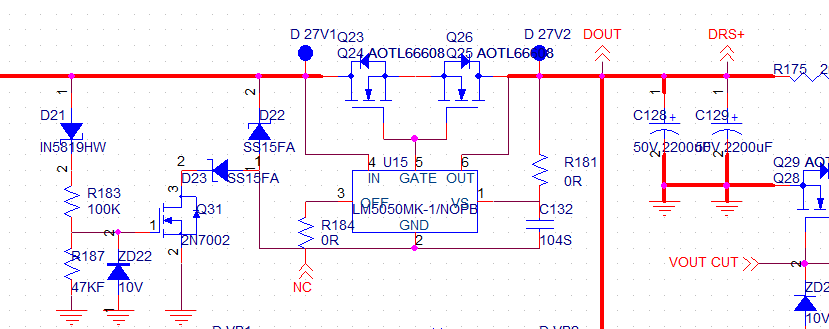

I have a 1000W  power project using lm5050. Because this IC is used for the first time, please help me to have a look. The schematic diagram is as follows,

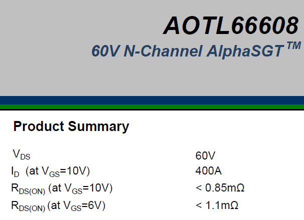

There are two power supplys, so 2pcs lm5050 are used like datasheet), one power supply is 27V 1000W, another is 24V lead-acid battery, power 1000W, current more than 40A. Each LM5050 drives 2 pairs back-to-back N-MOS, which means 4 N-MOS q23, q24, q25 and q26 in picture above.  MOSFET is AOTL66608 like below
Could you help me to double check below: ow:
Question 1: Is the LM5050-1 gate driving capability sufficient to dirve 4N-MOS?
Question 2:  When the output voltage is higher than the input voltage, whether the IC can shut down MOS normally with this Back-to-back structure?
Question 3: Is there any difference or preferance for VS  connected to input  or the output?
Thank you very much!
Best Regards
  • Hi
    LM5050 can not be used to drive two back-back NMOS due to the gate drive.
    Because, MOSFET is turned off by connecting Gate to IN. For the first MOSFET, this means Gate-Drain is short, so this MOSFET will not be turned off.
    We recommend to use LM5060 along with LM5050 or LM74700.
