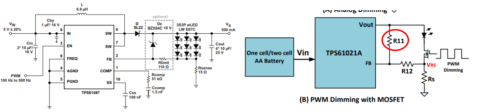

Our customer is trying to do LED dimming by inputting a 200Hz pulse signal to the EN pin as in the following application example (listed in the TPS61087 data sheet).
I would like to know about the following contents.
①By checking the above circuit example, I think that the above dimming is possible.
Is this possible even if the conditions such as input / output voltage change?
* By the way, our customers are trying to implement under the following conditions.
Vin = 3.0V-4.2V
Vout = 6.5V (or 6.0V)
Iout = 1.0A
Fsw = 650kHz
② Is there any concern when dimming the LED by inputting a pulse signal to the EN pin as in the above circuit example?
(I think it is necessary to pay attention to the responsiveness such as making the value of Rcomp larger than the calculated value of the data sheet.)

  • Dear Sir,
    It is very corner.  They need to choose a very small sense resistor Like 0.1-0.2 ohm. So can't output such big current.

  • Please check the calculation in the PMP15037.
    They need to change the circuit similar to PMP15037. Need to re calculate the dividing resistor and Rlimit.

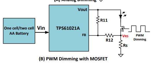

  • Dear Helen
    Thank you for your reply.
    I have a question about the calculation in PMP15037.
    1. I think that the dimming at the EN pin this time can be calculated by the resistance value in the circuit example below. Is this correct?
    (I think that R12 = Rlimit and Rs = Rsense.)
    ※ There was no circuit example for dimming with the EN pin on the PMP15037.
    If the question in 2.1. Is OK, there is no R11 in the application example in the datasheet. Do you need this resistance?
    Also, what happens to the calculation of R12 and Rs when R11 is not needed?
    3. Is the Rsense value as small as 0.1 to 0.2Ω when the LED in the circuit diagram of the TPS61087 data sheet Figure.21 is replaced with one LED with Vf = 6.15V and If = 1A?
  • Hi Ottey,
    The aim of PMP15037 is to reduce the loss across the Rsense, without R11, the voltage across Rs should reach Vref in order to regulate. So Rsense need to be higher than 1 ohm, results in a >1W loss with 1A LED current.
    You can ask the customer read the PMP15037 in detail, it is easy to be understand.  If they have MCU generate PWM signal, it is better to use the method in PMP15037.
    It has nothing to do with the one LED or multi LED .

  • Dear Sir,
    With R11, VFB is contributed by both Vo and Vsense.
    Without R11, VFB only contributed by Vsense.  And because of the big loss at Rsense, the total eff. is low.  For example, in this customer application, since it need >85% eff. With a big Rsense, the eff may lower than 75%.
