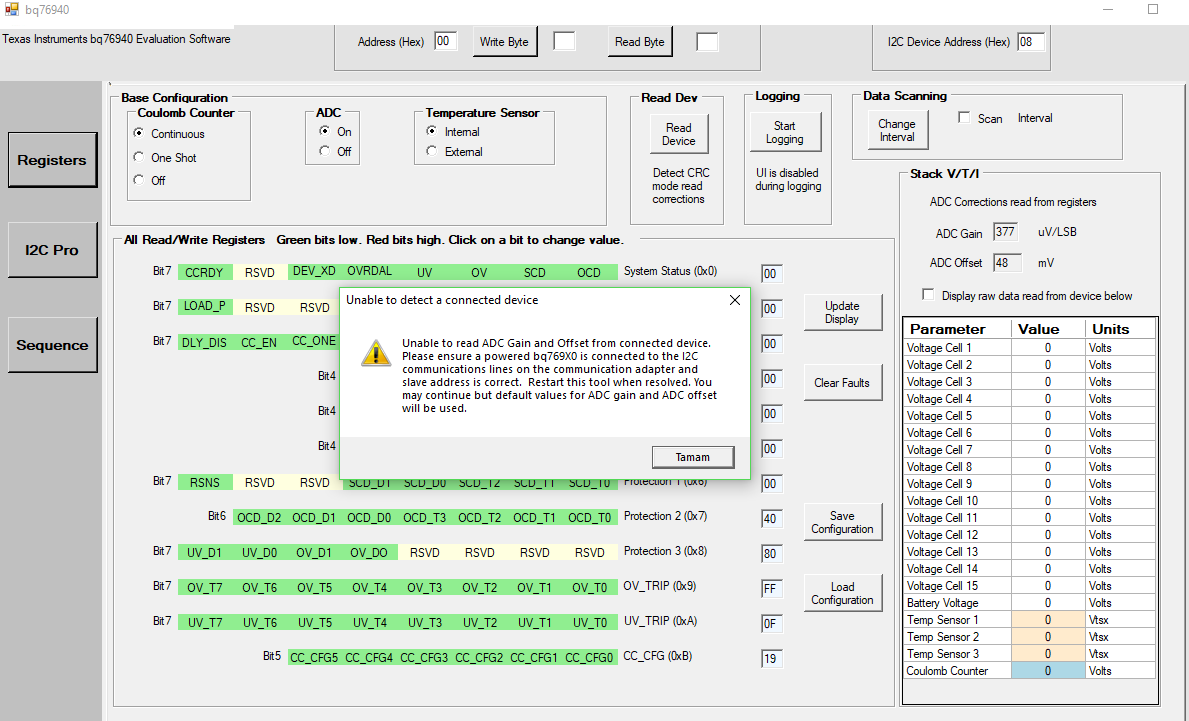

ı am woeking bq76930 evm sor 10 series ı have been using ev2400 for monitoring with bq769x0 evaluation software but recently ı have errors and ı understand it is comminication issues.there was no problem till yesterday.how can i solve this problem?
I added the data I saved to the registers recently  while working and the error image.
Thanks in advance for your help.

    I'm not sure why the communication would stop working if it was working before, but here are a few things you can try:
    • Make sure to follow all of the steps in the EVM User Guide Quick Start section like:
      • The shunts from the headers connecting the AFE to the gauge should be removed. These are located in the upper left-hand corner of the EVM.
      • 4-pin cable is connected between EV2400 and EVM I2C connector
      • USB cable connected from PC to EV2400. Three green LEDs should be on for the EV2400
      • Ensure power supply is connected to EVM BATT terminals
      • Press and release the BOOT switch on the EVM to wake up the BQ76930
    • If the EV2400 is suspected, you can re-program the EV2400 firmware. The latest firmware and the instruction for installing are located in the EV2400 product folder.
    I hope this helps you to find the issue.

    I tried but it can not be help. Is it possible that the device shifted to  ship mode ; if it is so what can ı do then?
    Because I cant reach SHUT_A and SHUT_B registers to achieve and ı supplied with approximately 1.5 V  TS1 pin to wake up device and still didnt work.I am working with BQSTUDİO simultanously  by the way; and same problem was there so  I cant used  commond SHUTDOWN disable.
